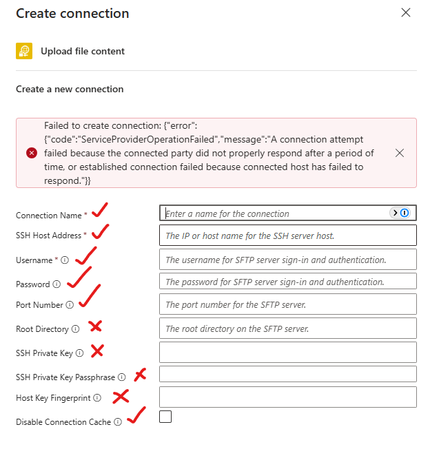

What we are trying to do is create a workflow action "Upload file content" which takes me to fill in details as below using sftp server , username and password and port, but no luck
What we did is below:
  1. VNET Integration to logic app
  2. Added a NAT Gateway and whitelisted NAT Gateway IP (Public IP addresses)
  3. SFTP Connection fails and also cannot see any trace network side
Still we are not able to create a workflow action. Please advice what is missing.

    SFTP Builtin connector worked with whitelisting only NAT Gateway. Earlier we had misconfigured or not properly configured whitelisting. Corrected it and it worked.

    Hi @VijAz
    Thank you for reaching out to Microsoft Q&A.
    In order to resolve this issue, Refer the solution below:
    Whitelist Azure Logic Apps outbound IPs (official but broad)
    You must whitelist Azure Logic Apps outbound IP ranges for your region, not the NAT Gateway IP.
    Microsoft publishes these ranges, and this is the only supported way for SFTP (Built‑In)
    Downsides:
    Large IP list
    Changes over time
    Often rejected by security teams
    Refer this document to troubleshoot same error: https://learn.microsoft.com/en-us/connectors/sftpwithssh/#504-error-a-connection-attempt-failed-because-the-connected-party-did-not-properly-respond-after-a-period-of-time-or-established-connection-failed-because-connected-host-has-failed-to-respond-or-request-to-the-sftp-server-has-taken-more-than-000030-seconds
    Instead of using SFTP Built in connector use SFTP SSH managed connector: https://learn.microsoft.com/en-us/azure/connectors/connectors-sftp-ssh?tabs=consumption
    This connector:
    Has more predictable outbound behavior
    Is commonly used when IP whitelisting is required
    Still uses Azure service IPs (not NAT), but works reliably when whitelisted correctly
    Enterprise‑grade fix (single outbound IP)
    If your requirement is one fixed outbound IP:
    Architecture
    Logic App > Azure Function (VNET + NAT) > SFTP
    Azure Function honors NAT Gateway
    Single static outbound IP
    Full SSH control, logging, retries
    Widely used workaround in locked‑down environments The SFTP‑SSH (Managed) connector is fully managed by Microsoft and is not deprecated (only the older “SFTP managed” connector is deprecated). With this connector, Microsoft handles networking, scaling, and outbound connectivity. If your SFTP server is publicly accessible, it may work without any additional whitelisting, which explains why you observed it working successfully. This behavior is expected and by design.
