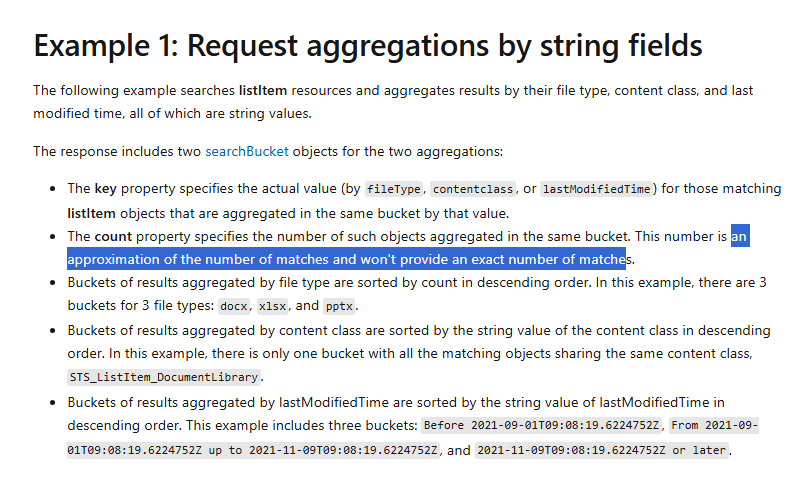

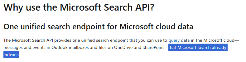

    First, according to Microsoft documentation, the Microsoft Graph Search API relies on the Microsoft Search index, which is designed for relevance-based discovery, not compliance-grade enumeration.
    Additionally, Microsoft documentation notes that even when using refined queries with aggregations, the returned counts are approximate and do not represent an exact number of matches. Because of this behavior, the Search API is not reliable if your goal is to discover all files precisely, as results are approximations rather than a guaranteed complete set.
    Because of this, the Search API should be considered best‑effort, not authoritative, for discovering all files that meet a specific compliance condition such as a sensitivity label.
    Regarding a cap on the total number of results, from my research, Microsoft does not document any explicit limit. As such, there is no confirmed maximum, but there is also no guarantee that paging will return every matching item, as the returned counts are approximate.
