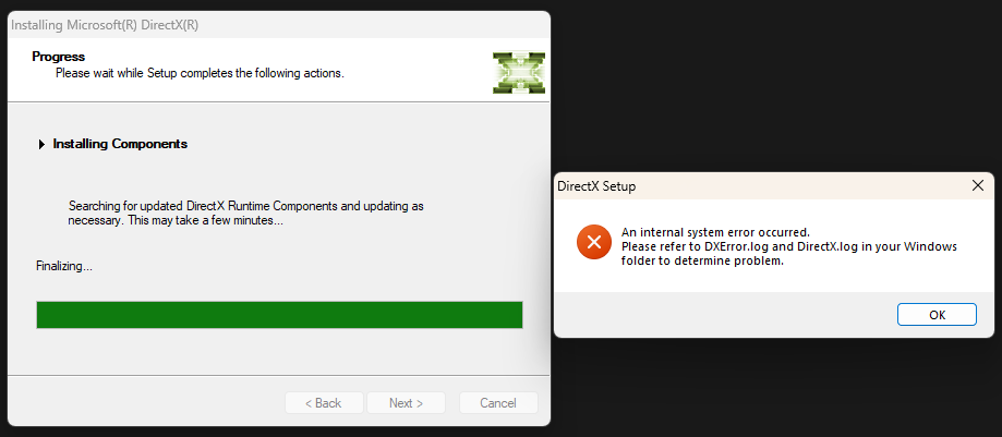

The situation is I'm trying to open Valorant but the error
"The following component(s) are required to run this program:
DirectX Runtime" pops up.
I have tried the installing DirectX setup again (dxwebsetup), but it fails and says "An internal system error occurred. Please Refer to DXError.log and DirectX.log in your Windows folder to determine problem.", which is what my problem currently is. I have no idea what to do with those logs.

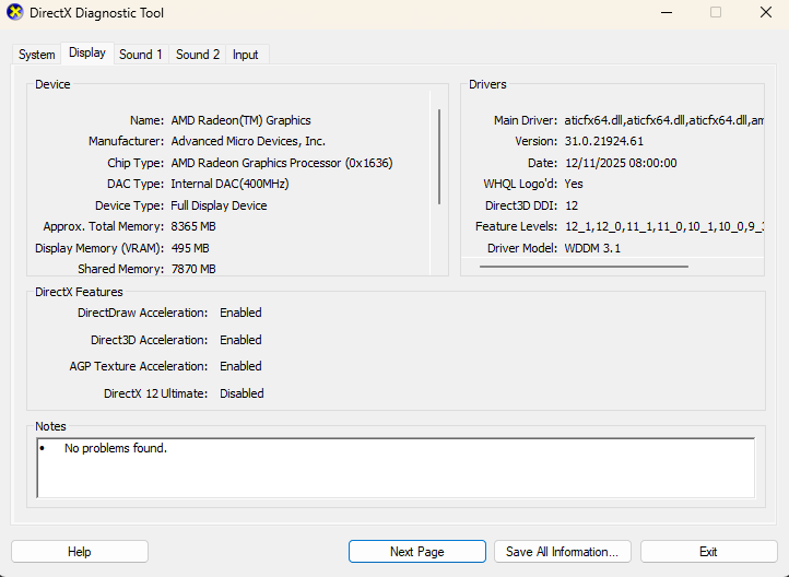

Click your Start Button, then just type dxdiag and press Enter.
On the resulting DirectX utility, select the Display tab.
Please provide a screenshot of that Display tab.
Thank you for the screenshot, there is no problem indicated there.

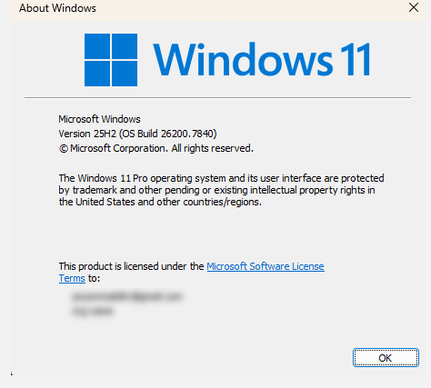

Click your Start Button, then just type winver and press Enter, please provide a screenshot of the resulting dialog box.
I don't have any 3rd party stuff, here's the dialog box though.
