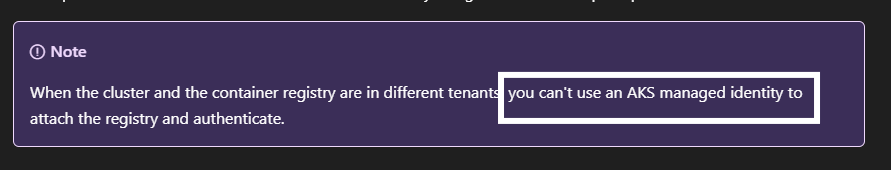

    Please note that you can't use an AKS managed identity to attach the registry and authenticate to it when AKS cluster and the registry are in different tenants which is most likely why you are getting error with your setup.
    Source: https://learn.microsoft.com/en-us/azure/container-registry/authenticate-aks-cross-tenant
