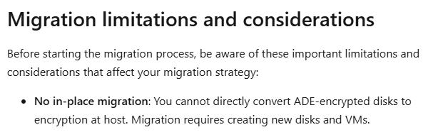

    Removing the Unified Data Encryption (UDE) flag from disks encrypted with Azure Disk Encryption (ADE) is not supported for migration to Encryption at Host. This does not make the disk compatible and may cause unsupported setups and risks.
    Microsoft does not support an in‑place conversion from Azure Disk Encryption (ADE) to Encryption at Host. This applies even if ADE is disabled and the disk appears decrypted.
    https://docs.azure.cn/en-us/virtual-machines/disk-encryption-migrate?tabs=CLI%2CCLI2%2CCLI3%2CCLI4%2CCLI5%2CCLI-cleanup#migration-limitations-and-considerations
