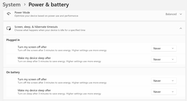

    2. Still in Settings, go to System > Power & battery > Screen, sleep, & hibernate timeouts:
      1. Set Make my device sleep after to the maximum value (e.g., Never)
      2. If you don't want your screen to turn off, also set it to maximum.
      3. Apply these settings for both Plugged in and On batteryUser's image
    Of course, this won’t remove the lock or sign‑in screen when you first power on your PC. But if you’re okay with avoiding them after stepping away and returning, this setup may help make the experience smoother.

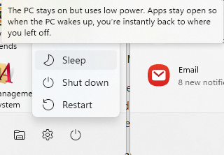

    In settings, what have you selected for the computer to do when you close the lid?
    Using Start, you can put your laptop to sleep. See example image below.
    Have you read the User Manual for your laptop?
