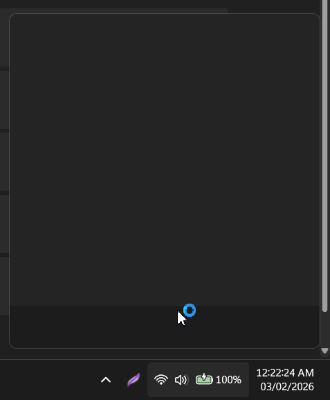

The past couple days I have been unable to open up my Quick Settings menu. My cursor loads and a blank screen appears, which quickly disappears (image attached below).
I have tried:
-Restarting Windows Explorers
-sfc scan and DISM scan
-Installing the latest Windows Update
However, nothing has worked so far. Any ideas?

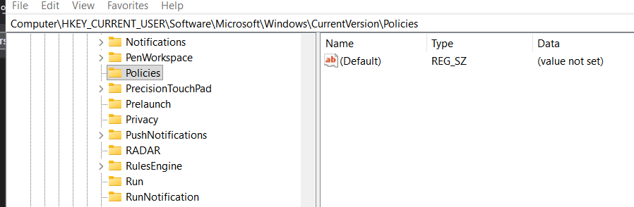

    • Press W + R to open Run.
    • Type regedit > press Enter.
    • In Registry Editor, click View > enable Address Bar.
    • Paste the following path into the address bar and press Enter: HKEY_CURRENT_USER\Software\Microsoft\Windows\CurrentVersion\Policies\Explorer
    • Double‑click DisableNotificationCenter
    • Set Value data to 0
    • If no DisableNotificationCenter exists > right-click the right pane > New > DWORD (32-bit) Value, name it DisableNotificationCenter set to 0, then reboot or sign out/in and test Quick Settings.
    This could restore default Windows behavior for Notification Center and Quick Settings.
