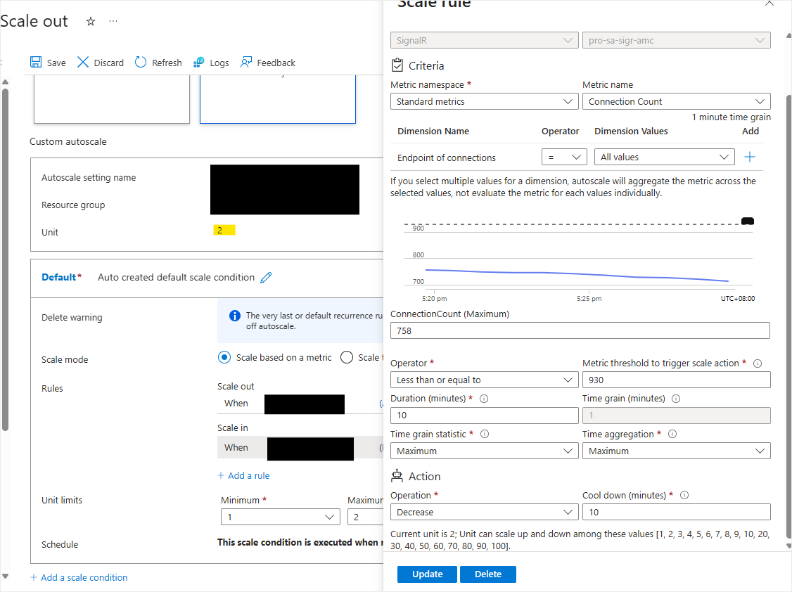

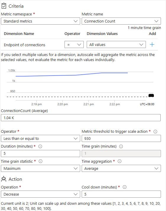

I have setup a metric conditions for scale in/out of SignalR. The scale out works perfectly but it will not scale in. The conditions was at below:
When the ConnectionCount (Max) is less than 930, it does not trigger. May I know how to resolve the problem?

    The most likely issue is a time aggregation mismatch in the autoscale configuration.
    Currently, the scale-in rule is configured as:
    Time Grain Statistic: Maximum
    Time Aggregation: Average
    This mismatch prevents the scale-in action from triggering correctly.
    Why This Is a Problem
    You are checking whether:
    Connection Count (Maximum) ≤ 930
    However, Azure evaluates the average of the maximum values over the selected duration.
    This means that if even one minute within the evaluation period has a maximum value greater than 930, the calculated average may still exceed 930 — even if the current maximum value is below 930.
    As a result, the scale-in condition does not get satisfied.
    Quick Fix
    Update the scale-in rule so that the aggregation matches the statistic.
    Current (Incorrect):
    Correct Configuration:
    Time Aggregation: Maximum
    The aggregation must align with the selected statistic.
    Update the rule as follows:
    • Metric: Connection Count
    Dimension: Endpoint of connections = All values
    Operator: Less than or equal to
    Threshold: 930
    Duration: 10 minutes (increase from 5 minutes)
    Time Grain: 1 minute
    Action: Decrease count by 1
    Cool Down: 10 minutes (increase from 5 minutes)
    Pls check and let us know.
