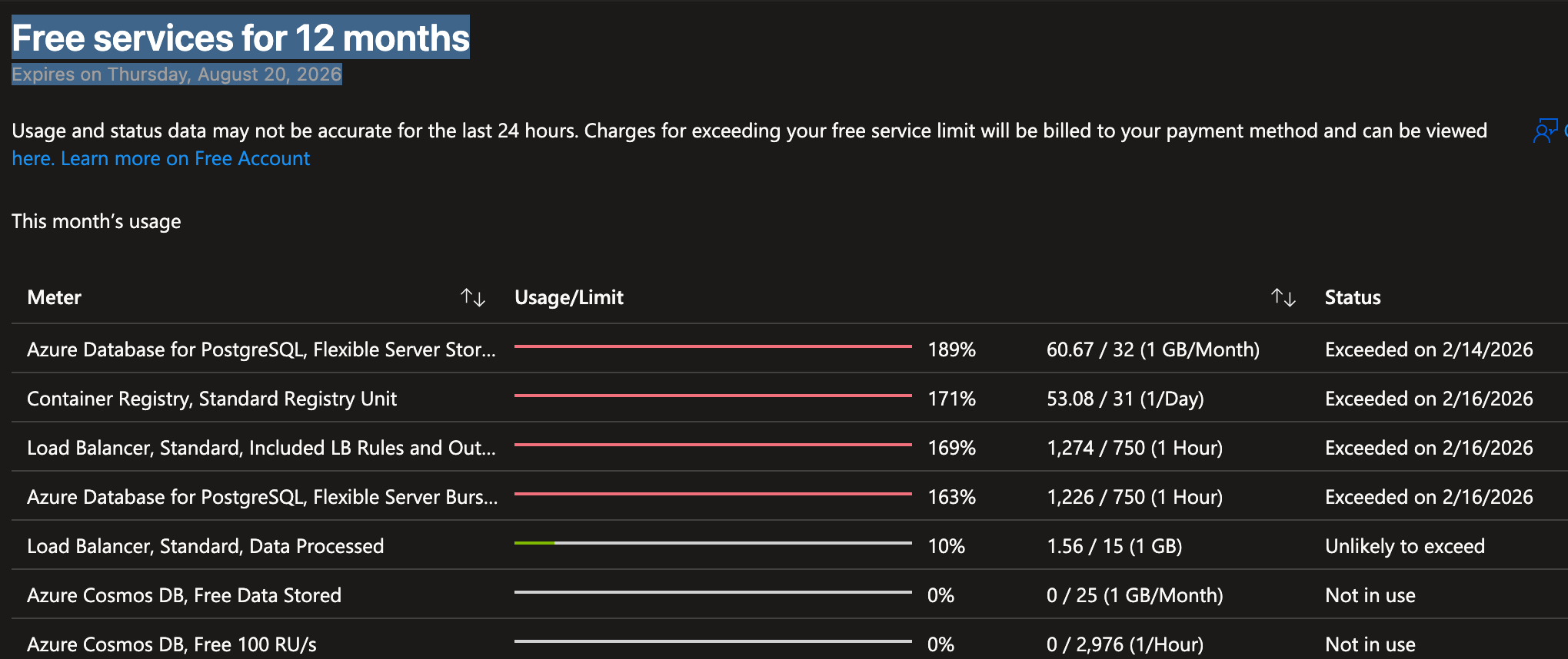

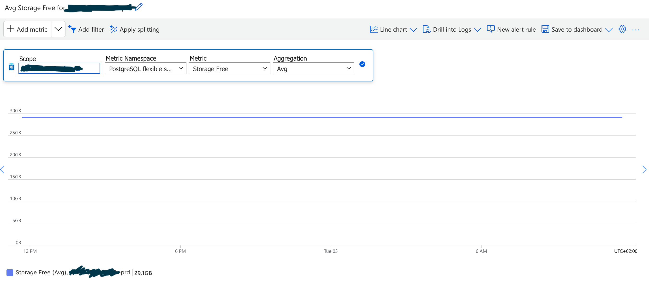

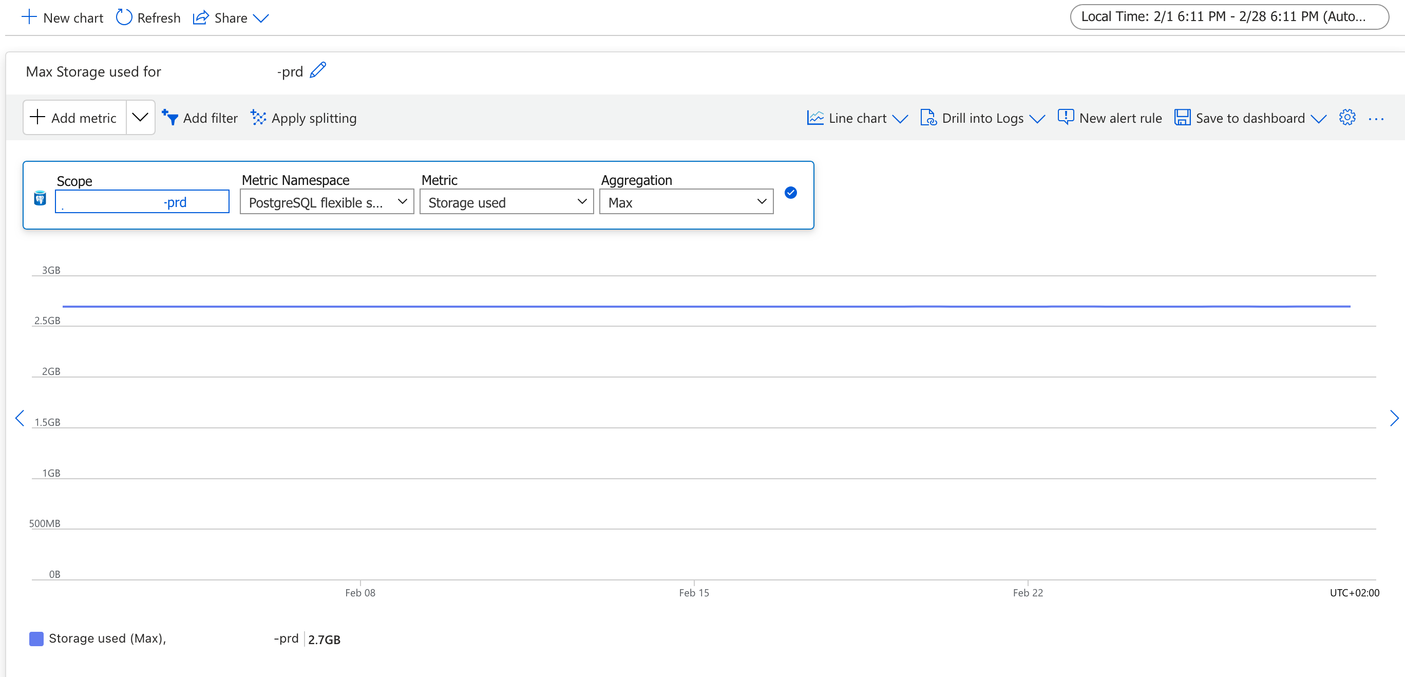

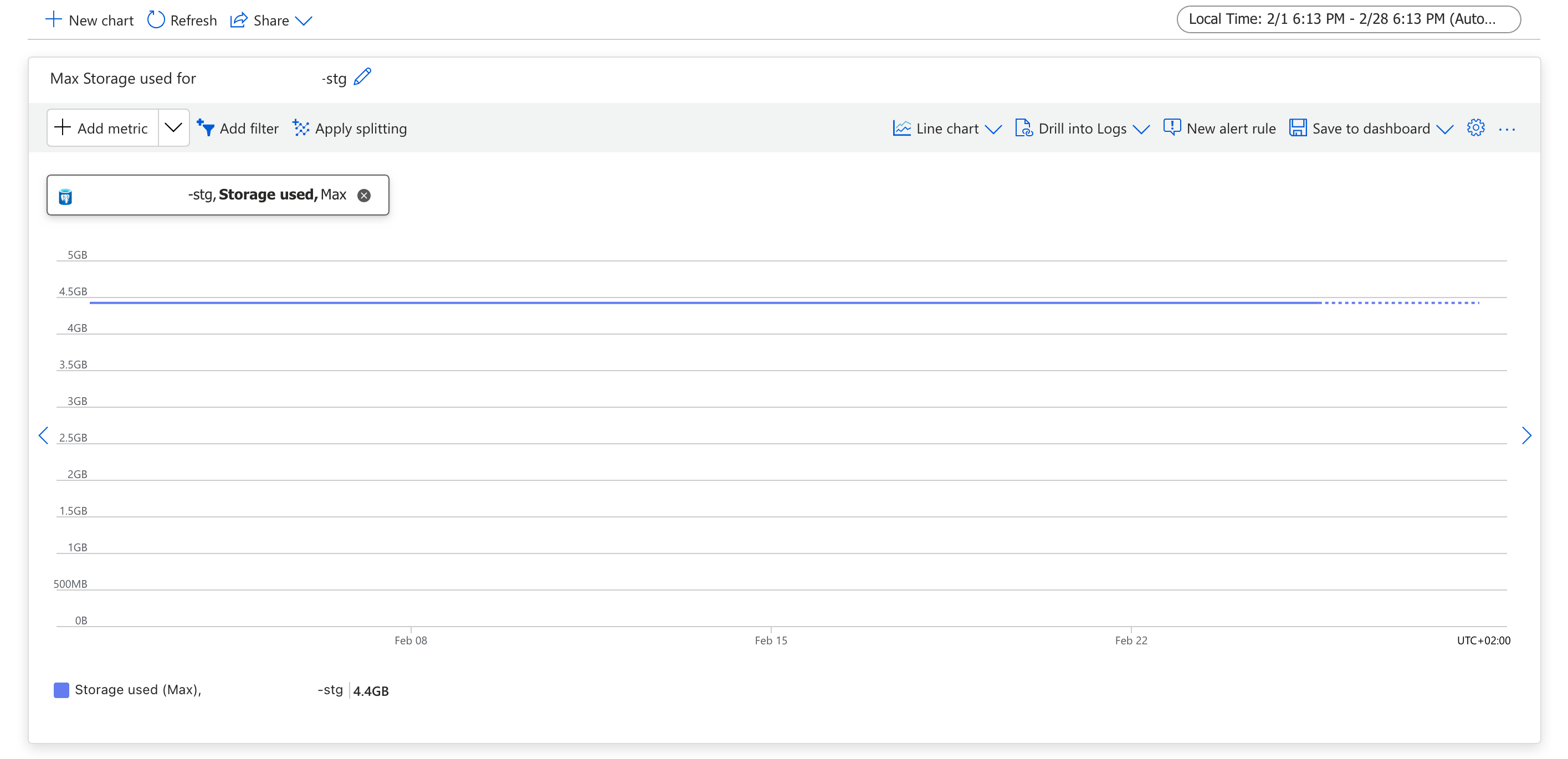

I see some strange PostgeSQL metrics under my Subscription: Azure Database for PostgreSQL, Flexible Server Storage, Data Stored This progress bar indicates an error status 189% 60.67 / 32 (1 GB/Month) Exceeded on 2/14/2026. But when I checked all storage sizes related to this server, I see that usage is under limit. It is like 29GB still should be free. So, this 60GB usage looks wrong and not true. And I pay for this wrong quota during few month. Could you support with this issue?
Also possible the same issue can be on: - Azure Database for PostgreSQL, Flexible Server Burstable BS Series Compute, B1MS - Container Registry, Standard Registry Unit - Load Balancer, Standard, Included LB Rules and Outbound Rules
It repeats every month, stating from Sep 16.

    It looks like what you’re seeing in the “Free services” blade is the provisioned storage meter, not simply the size of your tables or indexes on disk:
    1. “Data Stored” in the free-services view tracks the total storage provisioned (and includes things like transaction logs and server overhead), and it uses the same underlying storage_used metric that you can see in Metrics.
    2. Even though your actual database objects may only be a few GB, if your Flexible Server was ever configured (or auto-grew) above 32 GB of provisioned capacity, the free-tier meter will immediately show an overage.
    3. The “Storage Free” chart you pulled (showing ~29 GB free) is just a point-in-time snapshot of remaining provisioned space (for example on a 64 GB disk you’d see ~29 GB free if ~35 GB is allocated). It doesn’t reflect how the free-services blade accumulates usage across the month.
    Kindly check your server’s configured storage size in the Azure portal (Overview → Configuration).
    If it’s above 32 GB, you’ll always exceed the free-tier.
    In the Metrics pane, add the “Storage Used” (storage_used) metric and review it over the full month—in particular look at maximums or daily roll-ups. That will show exactly what the free-services meter is pulling.
    If you truly have never exceeded 32 GB provisioned and the meter is still incorrect, we’ll need to open a billing support ticket to investigate the free-tier meter data for your subscription.
    Please do let me know if you have any further concerns. I am happy to assist you.
