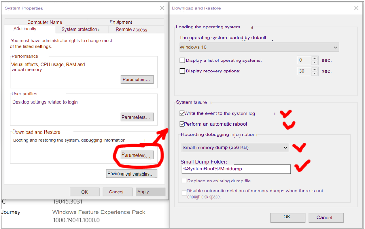

    Error 41(63) in most cases indicates hardware (not software) power problems. Less often - incorrect operation of the chipset driver. And even less often - for other reasons. Configure the system to receive minidumps:
    After the crash, the dumps will be written (if the problem is software) to the folder "C:\Windows\Minidump ". When they accumulate 3-4 pieces, upload the dump files to some file sharing site, and write the link here.
