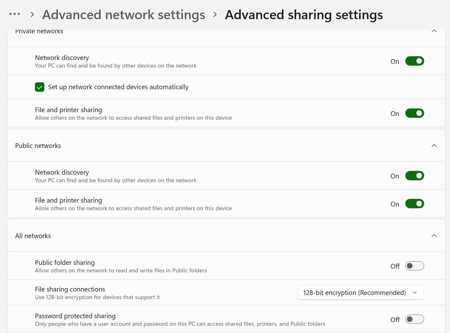

However, I recently discovered that I can no longer print from the 10 to the 11 computer shared printer. The error message was "Word can't print due to a problem with the printer setup'   I doubled checked all settings and discovery and file and print sharing is still turned on.  I can still share files back and forth on both computers just fine.

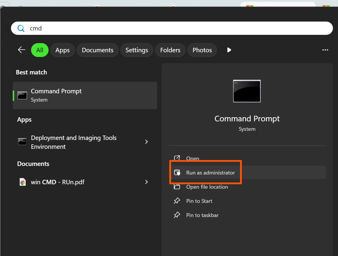

    • Regarding (RpcAuthnLevelPrivacyEnabled) set it as Zero for now.
      Follow the below CMD commands to run

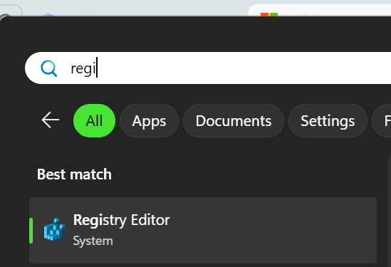

    1. Open (Registry Editor)
    2. "Computer\HKEY_CURRENT_USER\Software\Microsoft\Windows NT\CurrentVersion\Windows"
    3. Right Click on (Windows) key/Folder >> Permissions >> Add
      "Everyone" && Check mark "Full Control + Read"

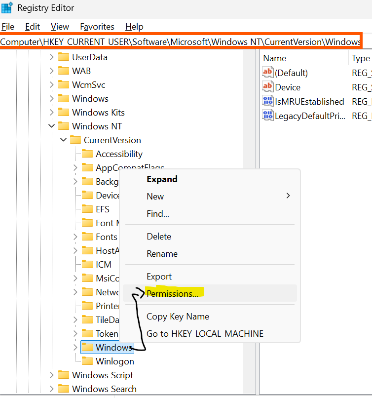

    Registry Permissions:
    1. Open the Registry Editor and navigate to: HKEY_CURRENT_USER\Software\Microsoft\Windows NT\CurrentVersion\Windows.
    2. Right-click the Windows key, select Permissions, and add "Everyone."
    3. Grant "Full Control" and "Read" permissions to Everyone

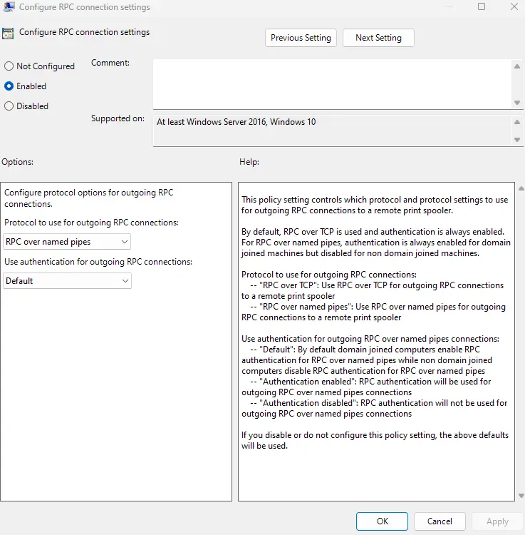

    Configure RPC Settings
    1. Navigate to: HKEY_LOCAL_MACHINE\Software\Policies\Microsoft\Windows NT\Printers.
    2. Create a new key named RPC if it doesn't exist.
    3. Inside RPC, create two DWORD (32-bit) Values:
      • RpcOverTcp (Set value to 0)
      • RpcOverNamedPipes (Set value to 1)

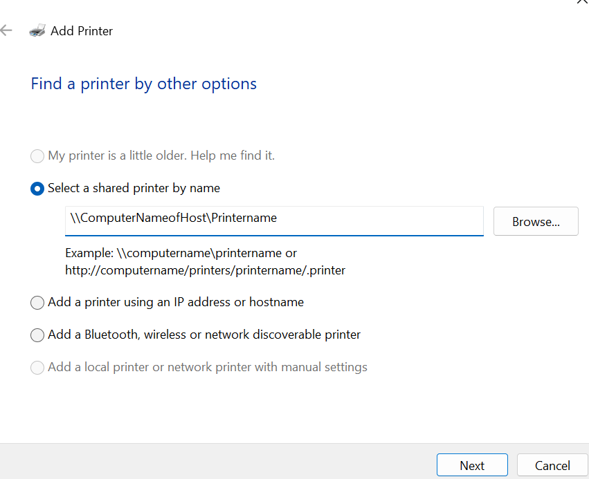

    Manually Add the Printer
    1. Go to Control Panel > Devices and Printers > Add a device.
    2. If not found, click "The printer that I want isn't listed."
    3. Select Select a shared printer by name and enter the network path to the printer manually
