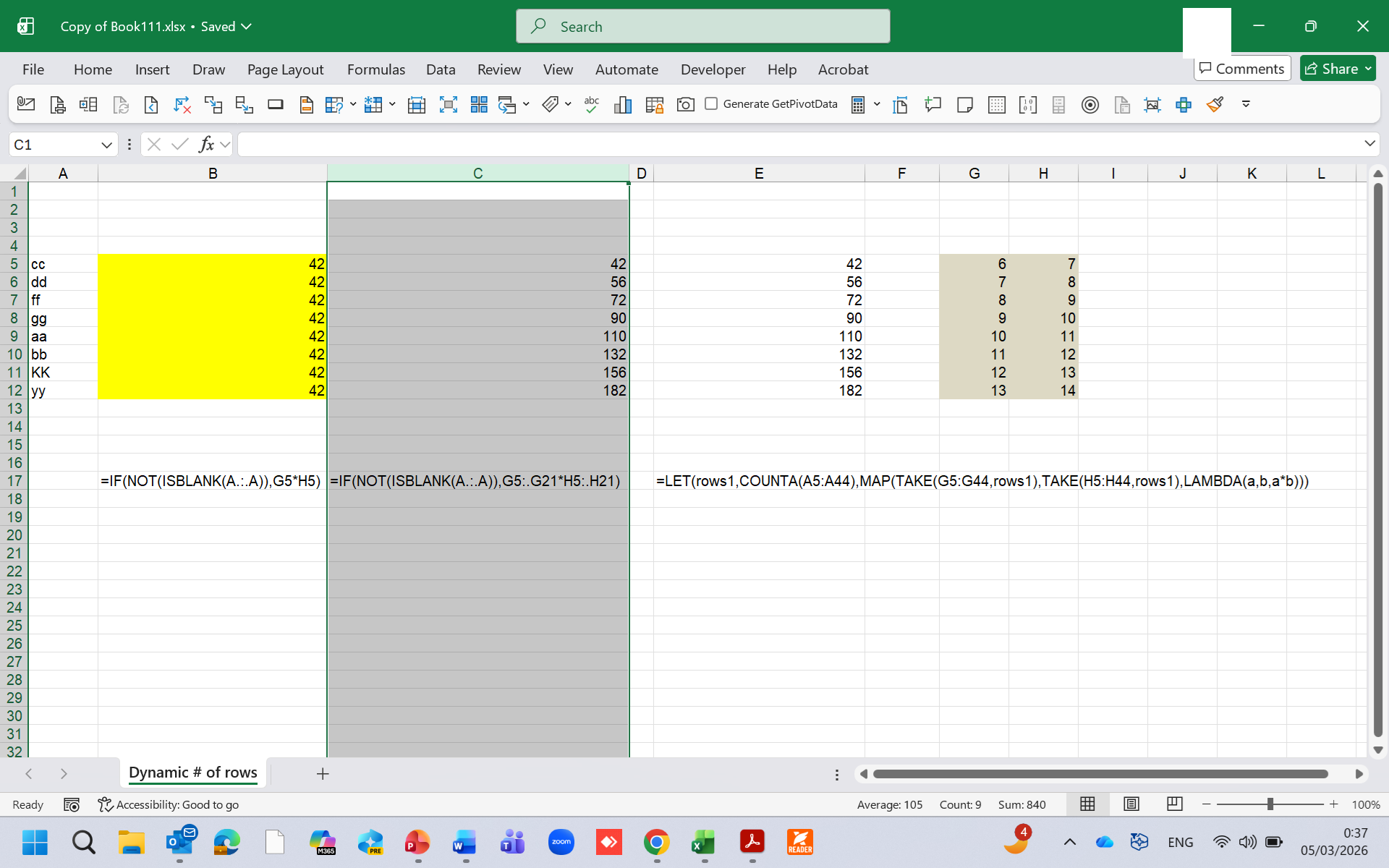

In an excel file I have a sheet with a few rows of data.
In a separate sheet I have a row for each row of data, such row includes numerous columns with complex formulas and calculations.
I am trying to make the number of rows in the calculation sheet increase / decrease dynamically based on the number of rows in the data sheet.
I was trying to find a way to "wrap" the existing formulas with Let, Map and Lambda. However I find this impossible to do since the dynamica array doesn't pull down formulas the same way dragging a formula down would do. Even if the references in the formula are not fixed (without $ signs) the reference is always to the first row.
I know this is solvable by refering to ranges, e.g.- instead of writing E4 you should write E4:E100 but it is not practical for me to change all the formulas accordingly, it is much more easy to just keep on dragging the formulas down manually.
Has anyone encounter such issue? found a solution? can confirm there is no solution?
Thx, david

  1. David Netser 0 Reputation points
    2026-03-04T23:42:34.75+00:00
    Hi, I have attached a screen shot of a simple example. Say the formula I would normally drag down is G5*H5 and I am trying automate the number of rows I want it dragged down based on Column A . I have used Formulatext in the bottom of each column. In column B I tried to wrap the formula but it will always return 42. Columns C and F do work but the acutal formula I have is too complicated to write it in thses ways, hope this is clear, Rgds, David
