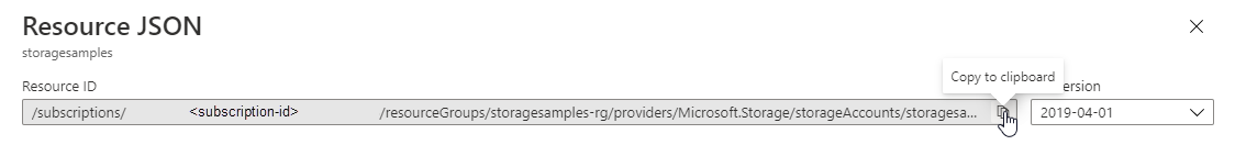

    Hello **Julie
    **You can absolutely point your Managed Instance VA to a storage account in another subscription – it isn’t limited to “same-sub” only. The trick is that when you call Update-AzSqlInstanceVulnerabilityAssessmentSetting you must reference the storage account by its full resource ID (or its key/SAS URI), not just by name. Here’s a quick PowerShell pattern you can adapt:
    # 1. Make sure you’re logged into both subs (or have a context for the storage sub)
    Connect-AzAccount
    # (Optional) Set context to the storage subscription so Get-AzStorageAccount will find it:
    Set-AzContext -SubscriptionId "<storage-subscription-id>"
    # 2. Grab the StorageAccount object
    $sa = Get-AzStorageAccount -ResourceGroupName "RG-Storage" -Name "myStorageAcct"
    # 3. Switch context back to the MI subscription if needed
    Set-AzContext -SubscriptionId "<mi-subscription-id>"
    # 4. Update VA on your Managed Instance
    -ResourceGroupName "RG-MI"
    -InstanceName "myManagedInstance"
    -StorageAccountName "mystorage"
    -ScanResultsContainerName "vulnerability-assessment"
    -RecurringScansInterval Weekly
    Key things to check:
    • Storage account must be GPv1 or GPv2, Standard performance, same region as your MI.
    • The MI’s managed identity (or your user principal) needs these roles on the storage account:
    • Storage Blob Data Reader (to read/write blobs)
    • Owner or User Access Administrator (to let VA save its settings) • You also need SQL Security Manager on the Managed Instance itself.
    If you still see “storage account not found,” double-check:
    1. That you’re targeting the correct subscription context when you call Get-AzStorageAccount or set the resource ID,
    2. That your PowerShell module (Az.Sql) is up to date, and
    3. Your identity has Microsoft.Storage/storageAccounts/read permission on that storage resource.
