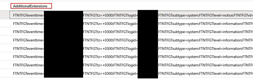

Hello,
I have a problem where the enabled CEF via AMA data connector outputs the ingested logs like this:

    FortiGate logs ingested through the CEF via AMA connector appear in the CommonSecurityLog table. Any CEF key–value pairs that Microsoft Sentinel does not map to a standard CommonSecurityLog column are stored in the AdditionalExtensions field.
    In the screenshot, the FTNTFGT* fields are vendor‑specific Fortinet keys that do not have built‑in mappings, so they are expected to appear concatenated in AdditionalExtensions rather than in separate columns. This does not indicate a parsing failure, only that these fields are unmapped.

    If the CEF header is valid and SECURITY_CEF_BLOB is present, the behavior where Fortinet‑specific fields appear in AdditionalExtensions is by design. Queries can extract these values from AdditionalExtensions using KQL parsing functions if needed.
