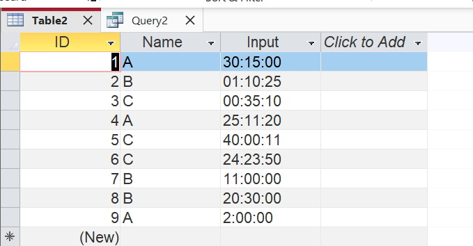

    If your duration values are less than 24 hours, you might want to try the approach suggested by Q&A Assist. In this case, you can keep the field as Date/Time and simply change the display format:
    -Open the table in Design View.
    -Select the Date/Time field where the duration is stored.
    -In Field Properties > Format, enter: hh:nn:ss  This will display values such as 00:35:10 instead of 12:35:10 AM, while still allowing you to perform calculations with the field.
    However, if your durations may be greater than 24 hours, the hh:nn:ss format will wrap after 24 hours. In that case, another option is to keep the duration as text (for example 30:15:00) and convert it to seconds in a query when doing calculations.

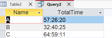

    For example, you can use a query expression like the following to calculate and display the total duration.
    TotalTime:
    Format(
    Int(
    Sum(
    Val(Left([Input],InStr([Input],":")-1))*3600 +
    Val(Mid([Input],InStr([Input],":")+1,2))*60 +
    Val(Right([Input],2))
    )/3600),"00")
    Format(
    Int(
    (Sum(
    ) Mod 3600)/60),"00")
    Format(
    Sum(
    ) Mod 60,"00")
    This converts the hours:minutes:seconds value into seconds for calculation and then formats the result back to hours:minutes:seconds when displayed, allowing durations longer than 24 hours to be added and displayed in the same format.
