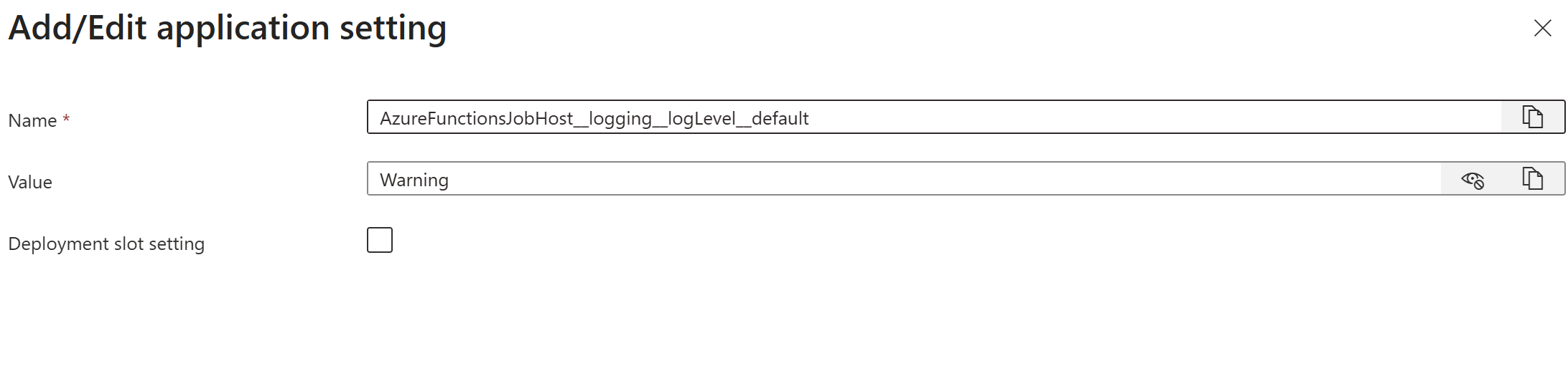

    Thanks for the offline conversation. Glad the issue is resolved.
    The setting:
    AzureFunctionsJobHost__logging__logLevel__default=Warning
    is an environment variable used by Azure Functions to control the default log level for the Functions host.
    If you have a host.json setting for logLevel.default, this environment variable takes precedence in Azure App Settings.
    Setting it to Warning helps reduce unnecessary Information or Debug logs, which can:
    • Lower Application Insights costs
    • Reduce noise in production logs

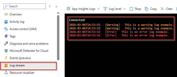

    1. Log streaming (“live” console output)
    • In the Azure Portal, navigate to your Function App
    • In the left-hand menu under Monitoring, click Log stream
    • You’ll see the real-time output (Information, Warning, Error) from your functions as they execute

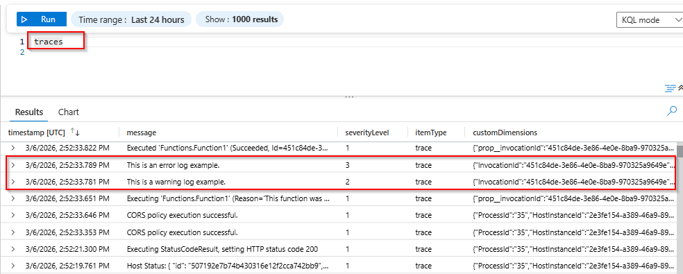

    1. Application Insights
    • Make sure you’ve turned on Application Insights for your Function App (via the Instrumentation Key or Connection String in Configuration =>Application settings)
    • Open the linked Application Insights resource, go to Logs, and run a query over the traces (or exceptions) table to see past invocations and log levels
    • You can also use Live Metrics Stream for a near-real-time view of incoming telemetry
