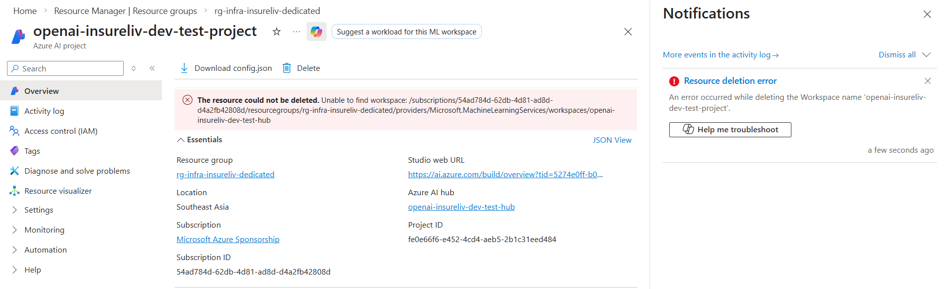

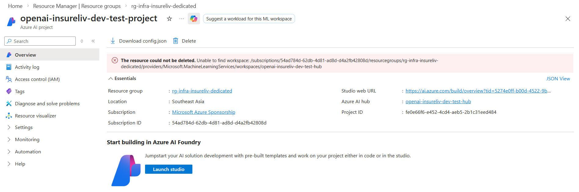

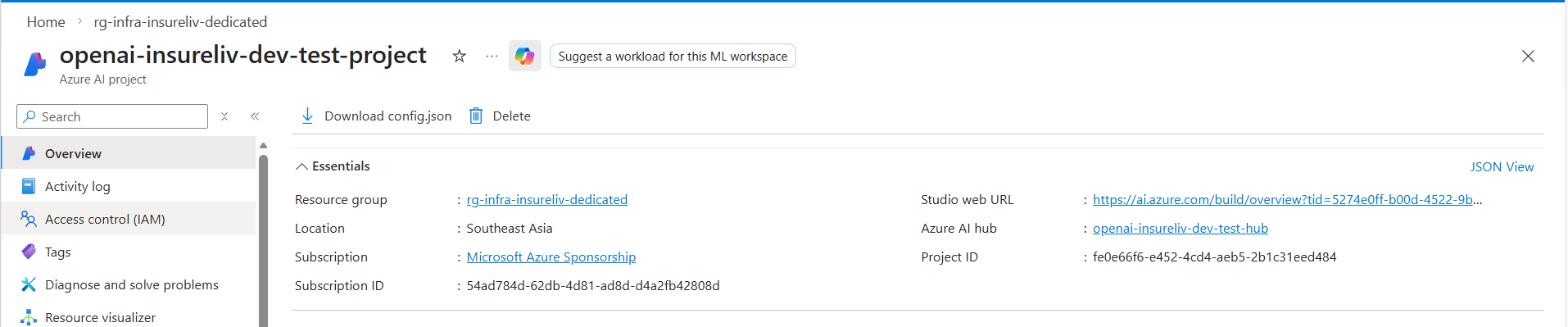

I am trying to delete an Azure AI Studio project, but I am encountering multiple errors related to the associated workspace. Earlier, I had manually deleted the Azure Machine Learning workspace that was connected to this AI Studio project. After that, the AI Studio project started showing errors and I am unable to delete it.
Current Situation
• The Azure AI Studio project still appears in the portal. • The original workspace that the project was connected to was deleted earlier. • When I try to recreate the workspace with the same name, Azure sometimes reports that a soft-deleted workspace already exists. • In some cases, the workspace shows as "Deleting" or fails during provisioning.

    Hi Nandhini K,
    Thank you for confirming that you were able to delete the ghost studio project eventually.
    Attached case summary for reference.
    Issue
    Customer was not able to studio project post deletion of Foundry Hub and always faced "project not found" error.
    Pointer shared from Support
    Share CLI command to delete the purged resources.
    Justified that ghost project won't incur any cost and suggested to move ahead with new studio project already
    Investigation from PG
    Product group found out that there was a bug on backend prohibiting.
    Status:
    Customer was able to delete the resource post confirmation from product group on 6th April
    Thank you for staying patient so far.
