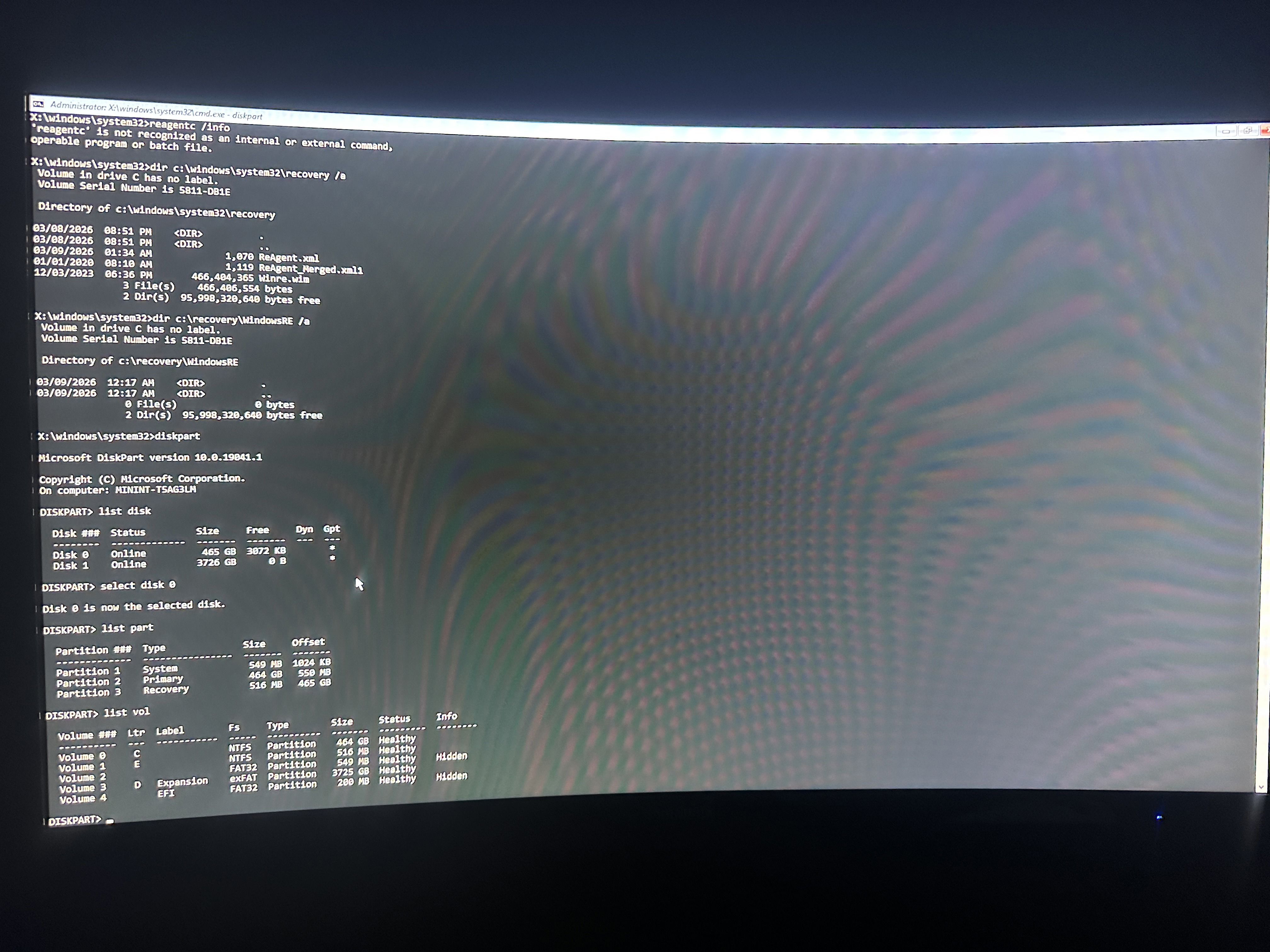

Similar to another post I saw on here my ReAgentC is not recognized as an internal or external command, operable program or batch file, after MBR2GPT conversion for Windows 11. I redownload Winre.wim from the Media tool for windows 22h2 Iso using 7zip, put it in my recovery folder, and then ran the commands presented to me in this other post. Everything went smoothly, I even saw winre.wim in the
dir c:\windows\system32\recovery /a
command, but as soon as I had to run a command using ReAgentC it was unrecognized. Ive tried all i could find so far and have no idea what to do, can I get some help here?

    I think it failed because the command was run from the X: prompt in WinRE.

    Ok. It appears that the Diskpart screenshot you posted is from Windows RE.
    Please boot into Windows. Open Command Prompt (admin) and run these commands:
    xcopy /h c:\windows\system32\recovery\winre.wim c:\recovery\windowsre\
    reagentc /info
    diskpart
    list vol
    exit
    Post the screenshot.

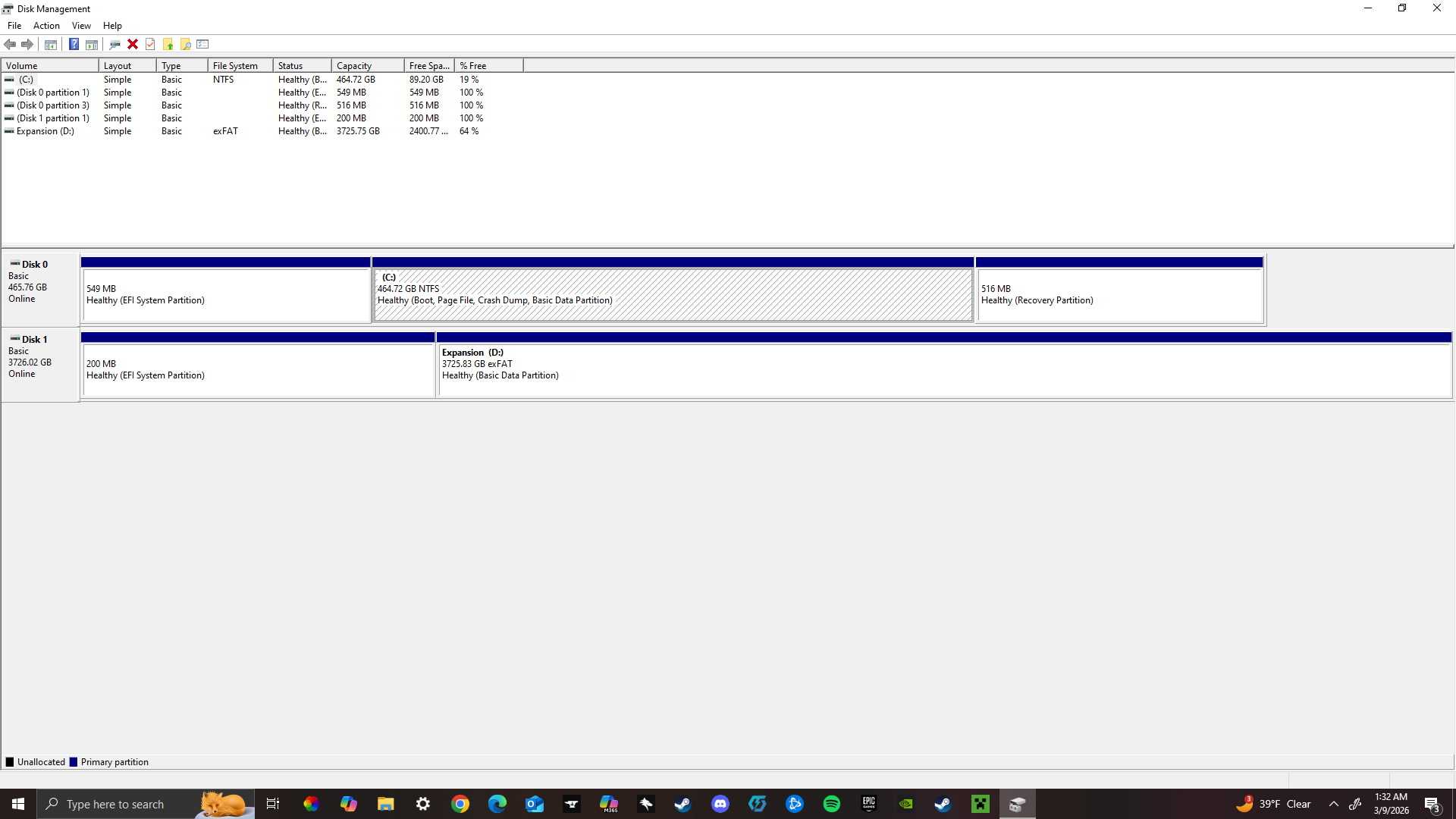

  1. Ramesh Srinivasan 77,800 Reputation points Independent Advisor
    2026-03-09T05:46:45.9833333+00:00
    Got the screenshots. Thanks.
    If you don't plan to use BitLocker drive encryption, WinRE can be enabled on the OS partition itself. Let me know if that's fine for you.
  2. Ramesh Srinivasan 77,800 Reputation points Independent Advisor
    2026-03-09T05:19:12.99+00:00
    Hi Ivan,
    Let me check the disk layout and WinRE's status. Please open Disk Management and maximize it. Adjust the column widths in the top pane to make all the entries visible. Post a screenshot.
    Open the admin Command Prompt and run these commands:
    reagentc /info
    dir c:\recovery\WindowsRE /a
    diskpart
    list disk
    select disk 0
    list part
    list vol
    exit
    Post the output.
