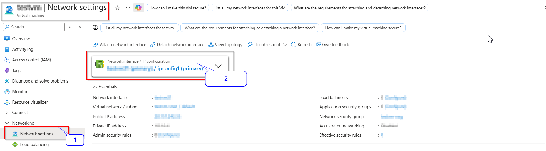

    First, stop the VM, then navigate to the networking settings as shown in the screenshot below.

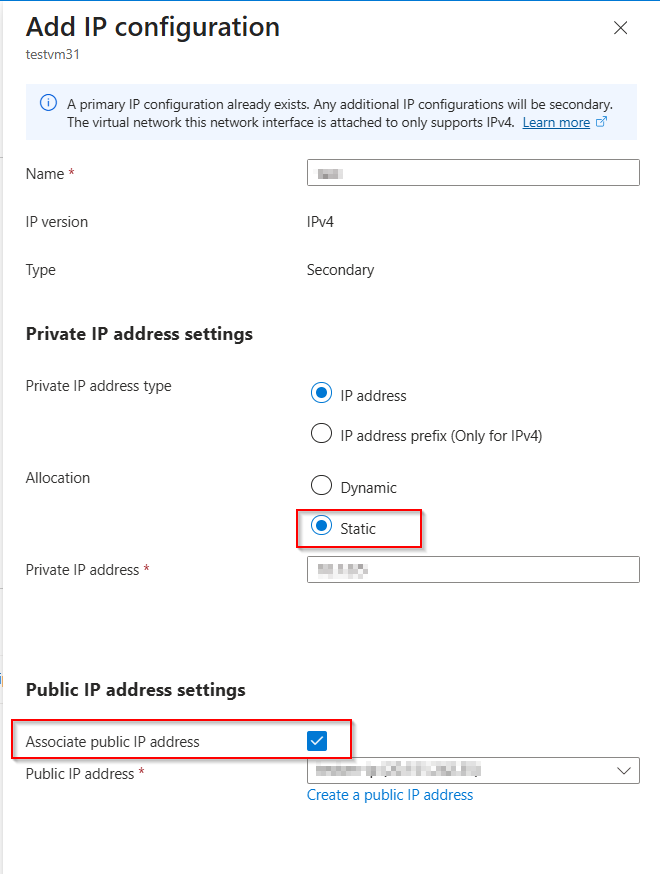

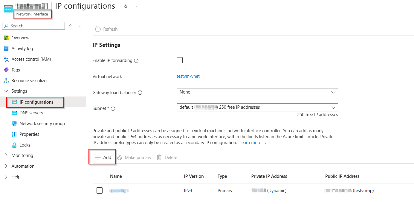

    After opening the Network interface, go to IP configuration and select ADD. Next, create a static private IP and click ADD again, as demonstrated in the screenshot below.

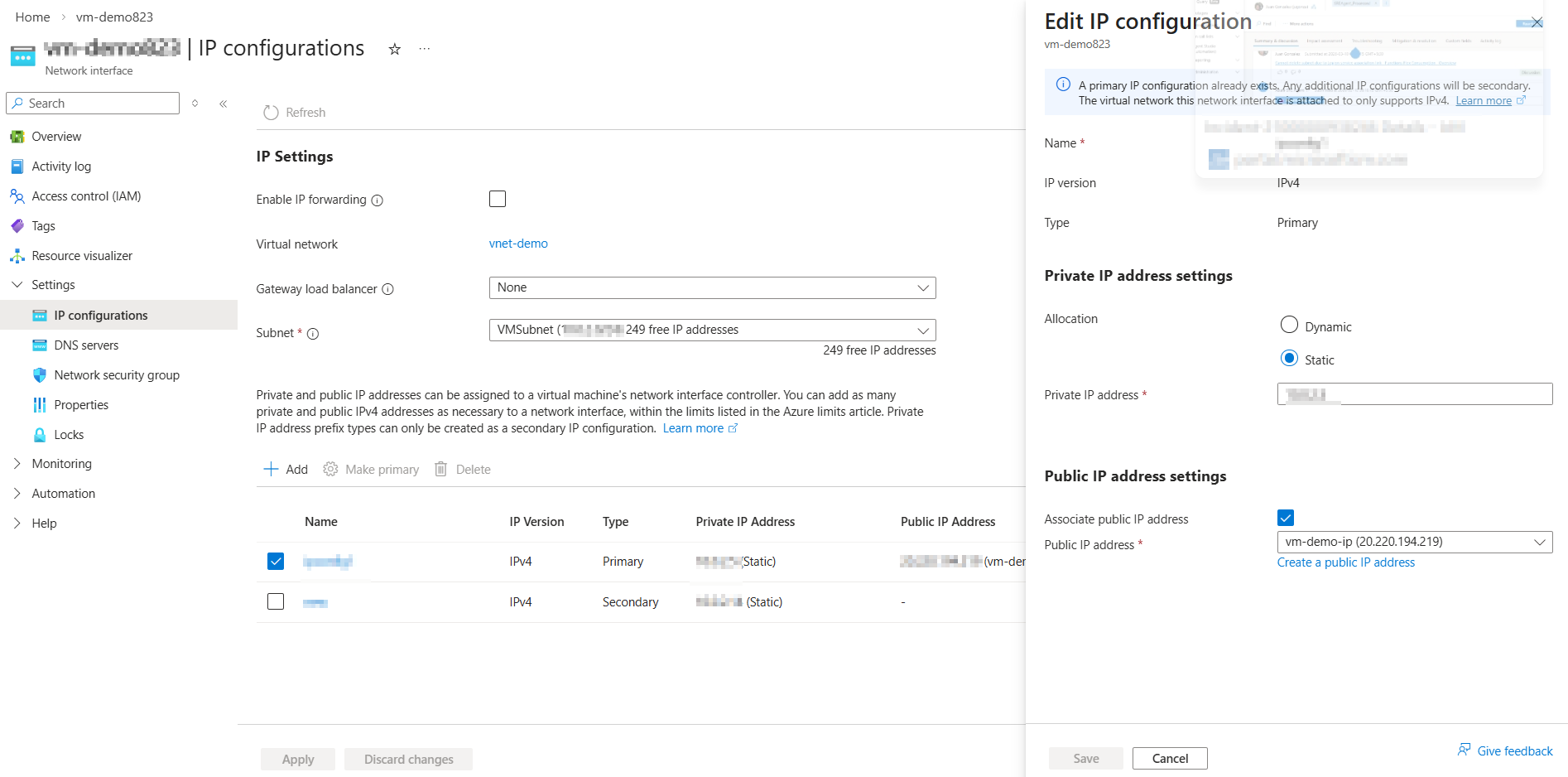

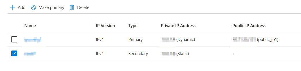

    Once you add the new private IP, it will appear in the IP configuration tab. You can then select the new private IP and set it as primary.
    If the previous step didn't set the new IP as primary, try clicking the old IP name and editing it directly. Select allocation as static, enter the new private IP address, and save. This will update it to the new private IP.

    1. Navigate to your VM in Azure portal, on left, click Networking -- Network settings
    2. On right, click on the Network interface/ IP configuration
    3. On IP Settings screen, bottom half, click on the IP configuration (typically named ipconfig1)
    4. On the flyout panel on right, change Allocation to Static, enter the new private IP in the box, click Save
