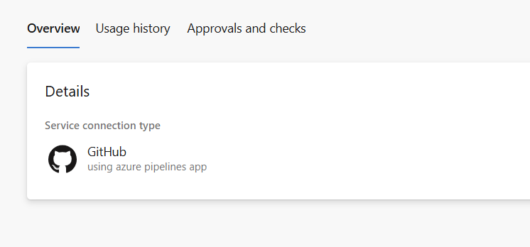

My pipeline passed but I nowhere see that the auth type is bearer or GitHub app but yes the service connection is using my GitHub app auth type. But in run logs I am not able to see. Can I confirm any other way

    It sounds like you want to be absolutely sure your pipeline is using the GitHub App rather than OAuth or a PAT. Azure Pipelines won’t stamp “GitHub App” or “Bearer” in every log line, but here are a few ways you can confirm:
    1. Check the Service Connection itself
      • Go to Project settings → Service connections in Azure DevOps.
      • Find your GitHub connection and open it – it’ll explicitly say “Authentication type: GitHub App.”
    2. Look at the “Get sources” step in a pipeline run
      • In the pipeline’s run summary, expand the “Get sources” (checkout) step.
      • You’ll see the name of the service connection that was used. If that connection is your GitHub App connection, the pipeline is using the App under the covers.

    To confirm that an Azure Pipeline is using GitHub App authentication (and not OAuth or PAT), use one of these methods:
    1. From Azure Pipelines UI
      1. Open the pipeline and select Edit.
      2. Select Triggers to open the classic editor for the pipeline.
      3. Go to the YAML tab and select the Get sources step.
      4. In the banner Authorized using connection: select the linked service connection name.
      5. In the service connection properties, check the connection type:
        • Azure Pipelines app → GitHub App connection
        • oauth → OAuth connection
        • personalaccesstoken → PAT connection
      If it shows Azure Pipelines app, the pipeline is using GitHub App authentication, regardless of what appears in the run logs.
