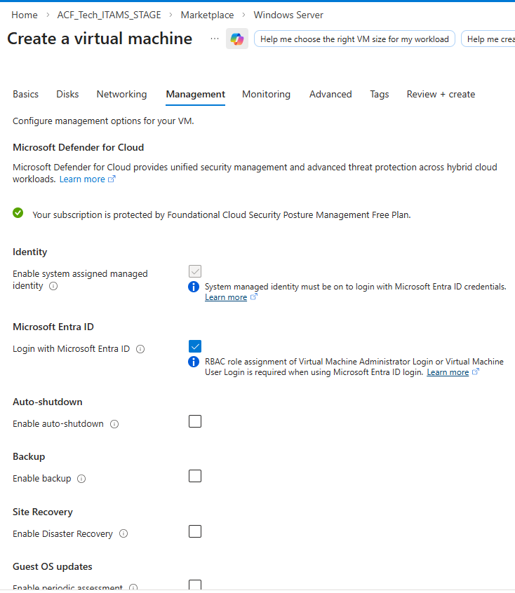

I’m attempting to enable Microsoft Entra ID authentication for a Windows VM that I access through Azure Bastion.

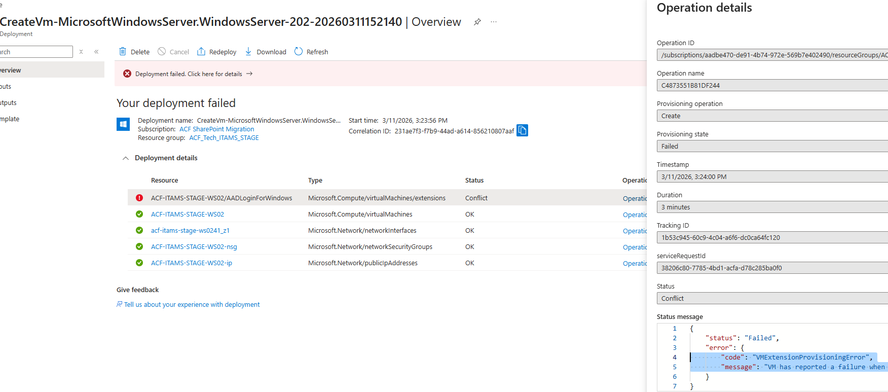

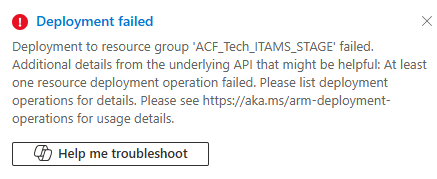

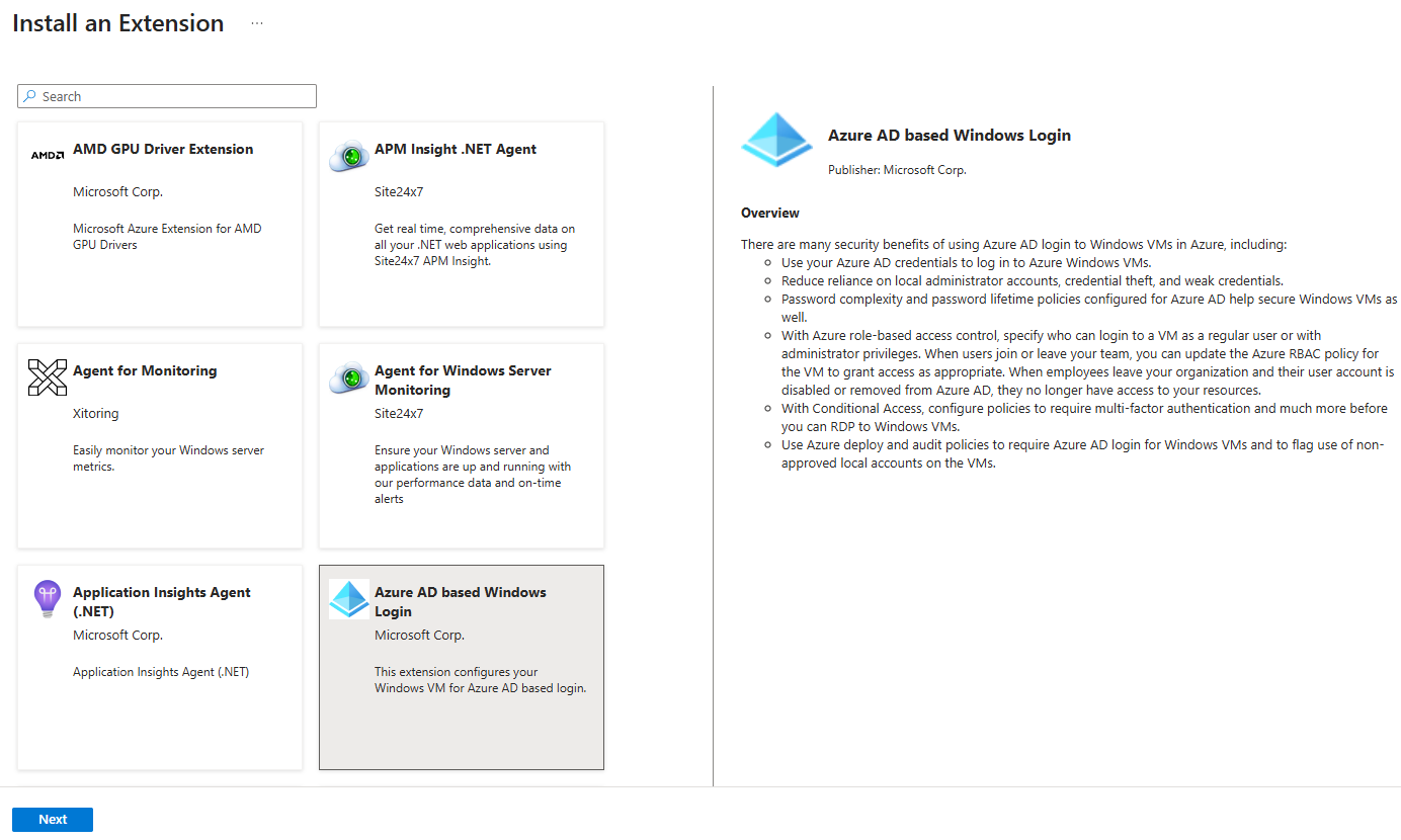

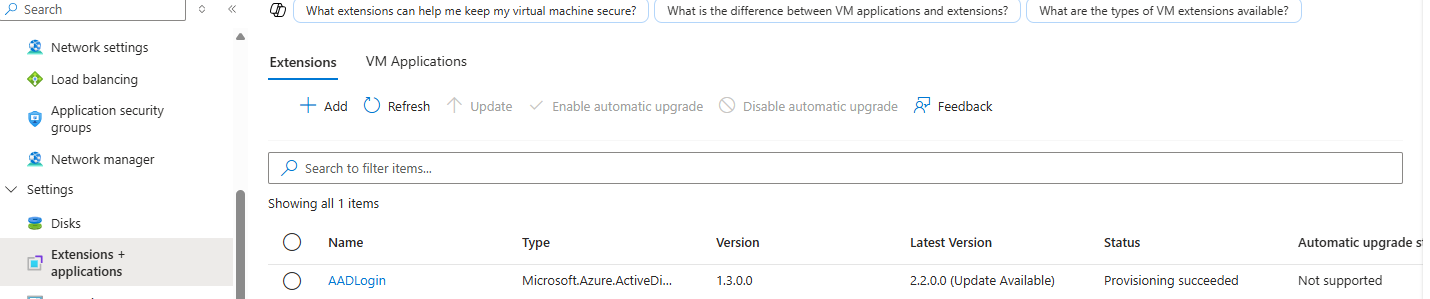

However, when I try to enable the AADLoginForWindows extension, the deployment fails and I receive the following error:
The handler for VM extension type 'Microsoft.Azure.ActiveDirectory.AADLoginForWindows' has reported terminal failure for VM extension 'AADLogin' with error message: 'Install failed for plugin (name: Microsoft.Azure.ActiveDirectory.AADLoginForWindows, version 1.3.0.0) with exception Command C:\\Packages\\Plugins\\Microsoft.Azure.ActiveDirectory.AADLoginForWindows\\1.3.0.0\\AADLoginForWindowsHandler.exe of Microsoft.Azure.ActiveDirectory.AADLoginForWindows has exited with Exit code: 50. Error: '.\r\n    \r\n'Install handler failed for the extension. More information on troubleshooting is available at https://aka.ms/vmextensionwindowstroubleshoot'"

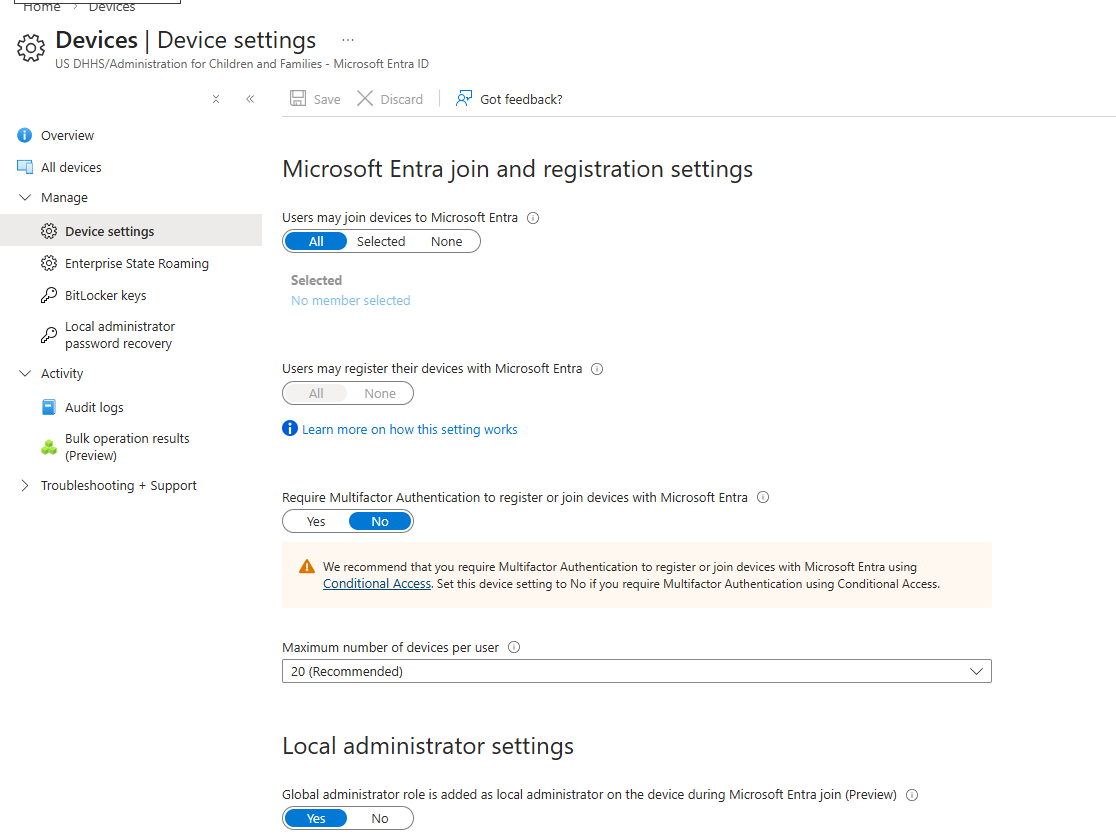

So far, I have:
Checked that the Microsoft Entra ID tenant is properly configured.
  • Confirmed the required RBAC roles are assigned.
    • Virtual Machine Administrator Login for admin privileges
    • Virtual Machine User Login for end users
Despite this, the extension installation continues to fail.

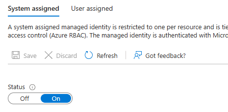

    2. Enable System Assigned Managed Identity
    The extension requires a system-assigned managed identity on the VM. Without it, the extension cannot retrieve tenant information from Azure Instance Metadata Service.
    Reference: https://learn.microsoft.com/en-us/entra/identity/managed-identities-azure-resources/how-to-configure-managed-identities?pivots=qs-configure-portal-windows-vm

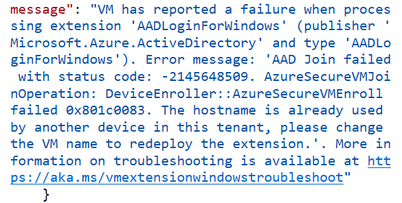

    Exit code 50 for the AADLoginForWindows extension indicates that the extension cannot complete the Microsoft Entra join on the VM. Use the built‑in troubleshooting flow for the AADLoginForWindows extension and the VM’s device join state.
    1. On the VM, check the extension logs
      • Connect with local admin credentials (for example via Bastion local account).
      • Open C:\WindowsAzure\Logs\Plugins\Microsoft.Azure.ActiveDirectory.AADLoginForWindows\1.0.0.1.
      • Review CommandExecution.log or CommandExecution_YYYYMMDDHHMMSSSSS.log for the detailed error that caused exit code 50.

      • If these calls fail or the tenant ID is missing, ensure the VM has a system‑assigned managed identity enabled on the Identity blade and that networking allows access to the metadata IP 169.254.169.254.

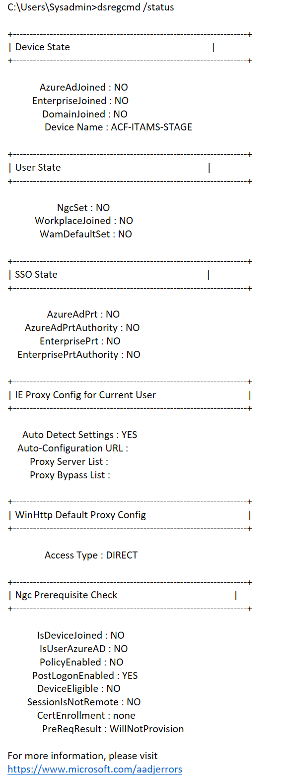

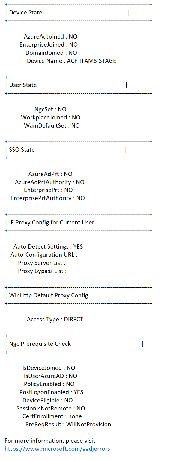

    4. Validate device join state
      • Run dsregcmd /status on the VM.
      • For a successful configuration, Device State should show AzureAdJoined : YES.
      • If not joined, use the errors in User Device Registration\Admin log in Event Viewer (Applications and Services Logs\Microsoft\Windows\User Device Registration\Admin) together with the extension logs to identify what is blocking the join (for example, tenant discovery, connectivity to enterpriseregistration.windows.net, or duplicate device name).
