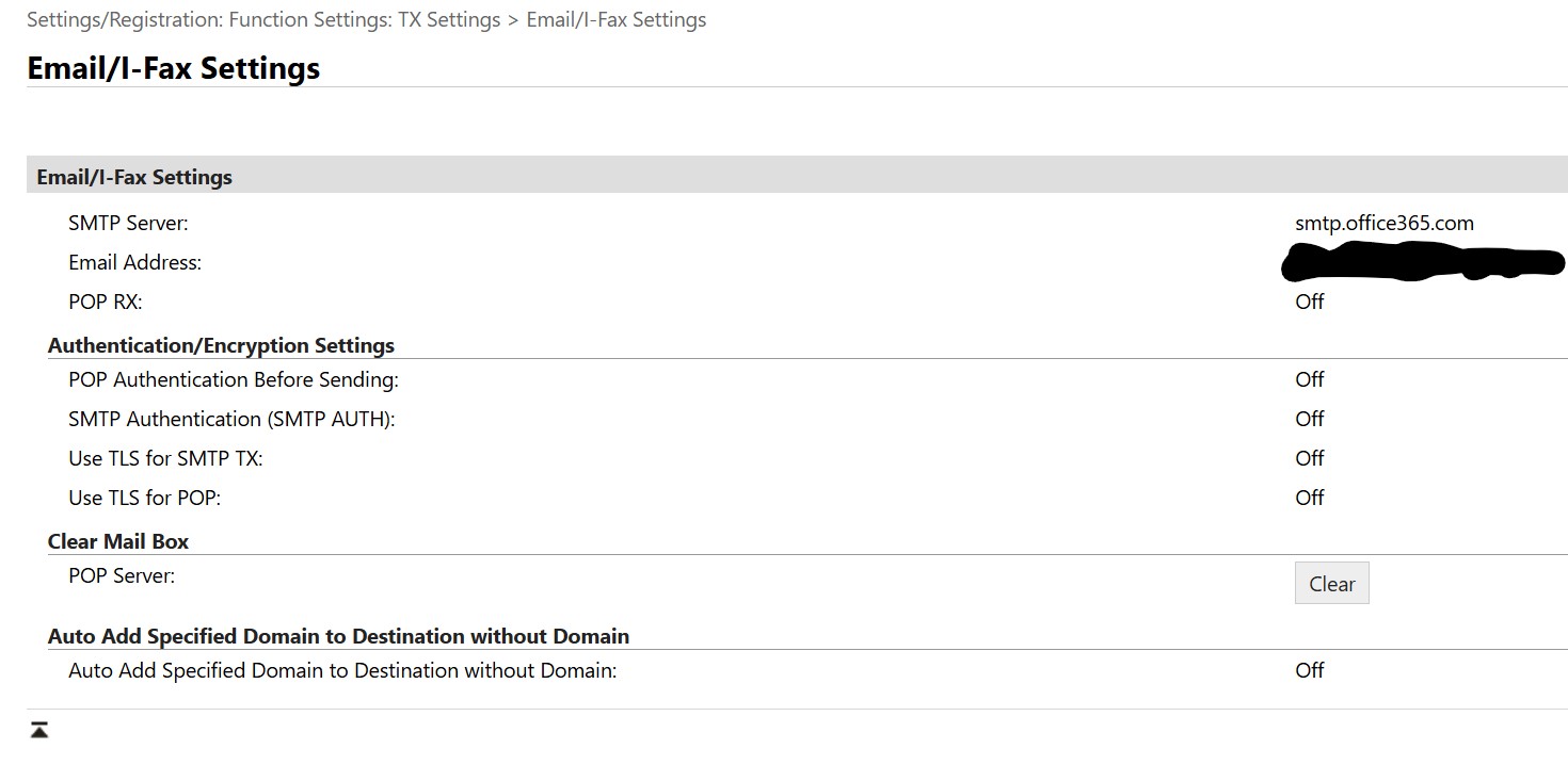

Hello,
Apologies if this is in the wrong group, but I have recently bought a new MFD which has scan to email which I need to use every day for my business. I have also just migrated over to Office365 and I am trying to set this up, but oh my word.. it seems to be the most convoluted and complicated thing I've ever tried to do and I've already wasted an entire day trying to set this up. Previously I could just use SMTP AUTH and it was a breeze!
Is there a simple how-to guide at all? Reading online, it looks like I'm far from the only person facing this problem and the online help on the Microsoft website sends me to about 15 different articles, all telling me different ways to do it which I'm assuming are all incompatible with each other as I've tried to follow the steps as closely as possible but nothing seems to have worked.
The scanner I have does support OAuth 2.0 and TLS 1.3 so the device should be ok but I'm at a loss to work out what I need to do within Azure / Entra / Exchange.

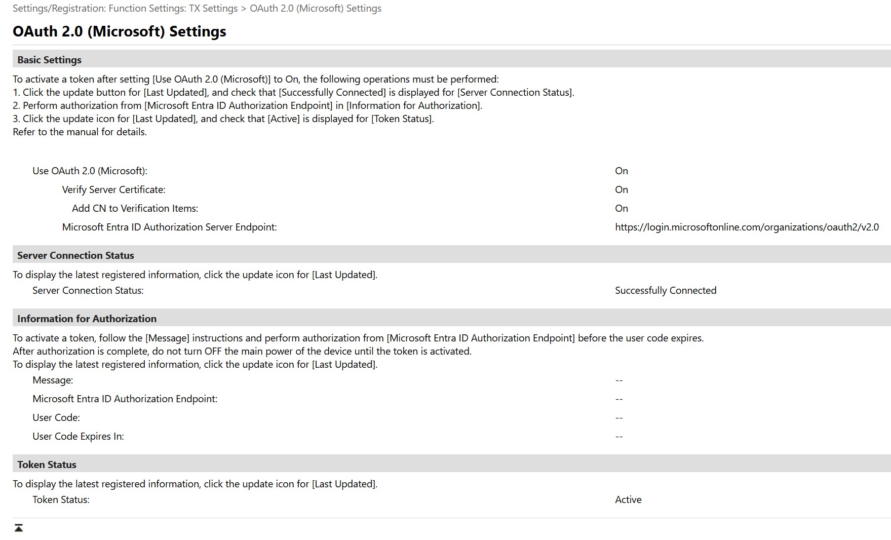

I did get to a point where OAuth said it was active and the smtp connection test on my MFD said everything was fine but I kept getting errors every time I tried to scan anything.
Any help would be greatly appreciate!

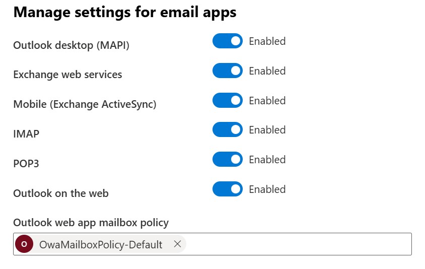

    2/ Enable SMTP authentication for the user
    Go to the Microsoft Admin Center and do the following:
    Select Users > Select Active users > Choose the user you created > Go to Mail > Enable SMTP authentication in the Manage email apps section
