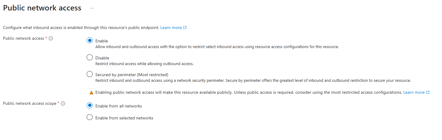

We want to deploy the AzUrlShortener container app in the production environment with VNet integration, so that it can access resources (Storage Account) through Private Endpoints with public access disabled.
Are there any changes required in the existing Bicep deployment template to support VNet integration for the Container App Environment, or can this configuration be handled after deployment in portal only?

    To get your AzUrlShortener Container App talking to a Storage Account over private endpoints with public access off, you’ll need to bake the VNet integration into your Container App Environment at deployment time. You can’t retrofit a completely new VNet into an existing environment via the portal alone. Here’s what you should do:
    1. Use a workload-profiles Container App Environment • Consumption-only environments don’t support VNet integration – make sure you’re on a “Workload profiles” (dedicated) plan.
    2. Update your Bicep template on the Microsoft.App/managedEnvironments resource to include vnetConfiguration and disable public access:

    VNet integration and private endpoint support for Azure Container Apps environments is determined at environment creation time and by the environment type, so changes are required in the Bicep template rather than only in the portal after deployment.
    Key points from the context:
    1. Environment type and VNet requirements
      • Private endpoints are only supported for workload profile environments (the default for new environments).
      • When using an existing VNet, a dedicated subnet must be provided for the Container Apps environment, and for workload profiles the minimum subnet size is /27.
      • Once an environment is created with either the default Azure network or an existing VNet, the network type cannot be changed later.
    2. Private endpoints and disabled public access
      • To use a private endpoint on the Container Apps environment, public network access must be disabled on that environment.
      • This can be done via CLI or portal, but in an IaC scenario it should be expressed in Bicep (for example, by updating the environment with --public-network-access Disabled as shown in the CLI flow).
