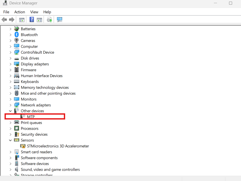

Hello,
I am experiencing a persistent issue with the MTP USB Device driver on my Windows system.
When I connect my Android phone to my PC via USB, the phone charges normally, but Windows does not properly detect it as a portable device.
In Device Manager, the device appears under Other Devices as:
MTP error
with the error:
“This device is not working properly because Windows cannot load the drivers required for this device. (Code 31)”
Because of this issue, Windows cannot recognize the phone for file transfer.

  1. Ramesh Srinivasan 77,725 Reputation points Independent Advisor
    2026-03-11T05:57:29.13+00:00
    Hi Sudheer,
    A third-party filter driver may be causing the problem. To verify that, please open a Command Prompt admin window and run the following command:
    reg query "HKLM\SYSTEM\CurrentControlSet\Control\Class" /f *erfilters* /s >c:\filters.txt
    Upload the file c:\filters.txt in your next reply.
