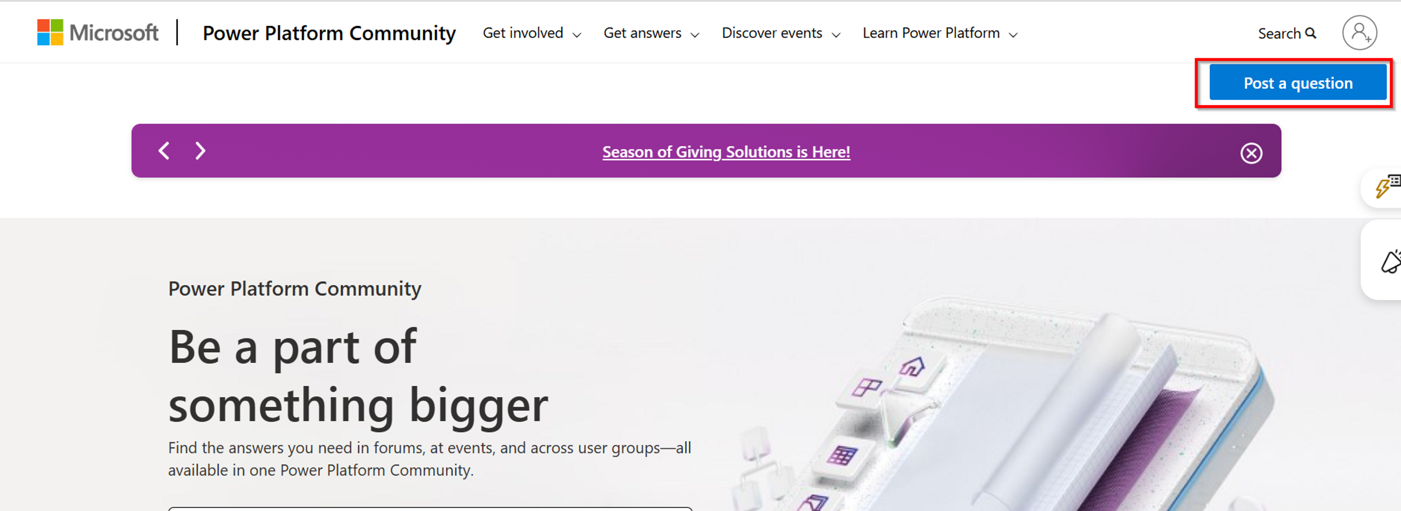

    Power platform related is currently not supported in the Q&A forums, the supported products are listed over here Supported products on MS Q&A (more to be added later on).
    You can ask the experts in the dedicated MS Power platform community forum.
    Can you please open as a new thread in MS Power platform community Find Answers | Microsoft Power Platform Community
    I hope it helps! and do let me know if you have further queries.
