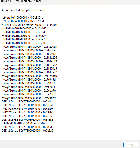

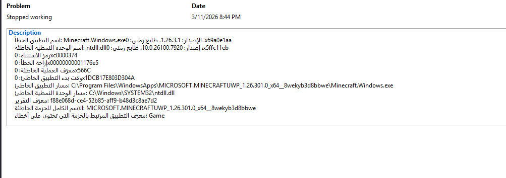

Peace be upon you, brothers. For about four months now, my computer has been crashing on its own with any game, even light ones. The school computer runs them better than mine. This problem has been happening for a while now, and I need a solution. I've checked all the parts and they're fine, but the computer still crashes.Screenshot 2026-03-08 012349

    The crashes shown in the screenshots are application crashes (unhandled exceptions in game executables and system DLLs like ntdll.dll), which are commonly caused by faulty drivers, corrupted system files, or unstable hardware/drivers rather than the games themselves.

    If, after these steps, the system still crashes only during games and no memory/disk errors are found, focus on GPU drivers and any overclocking or tuning utilities: disable or uninstall them and test again.
