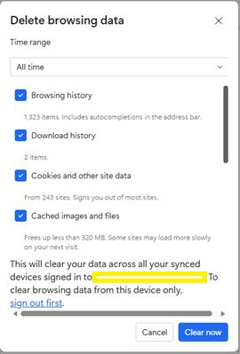

     B/ Clear browser session
    • Try InPrivate/Incognito
    • Or clear cookies for outlook.office.com
