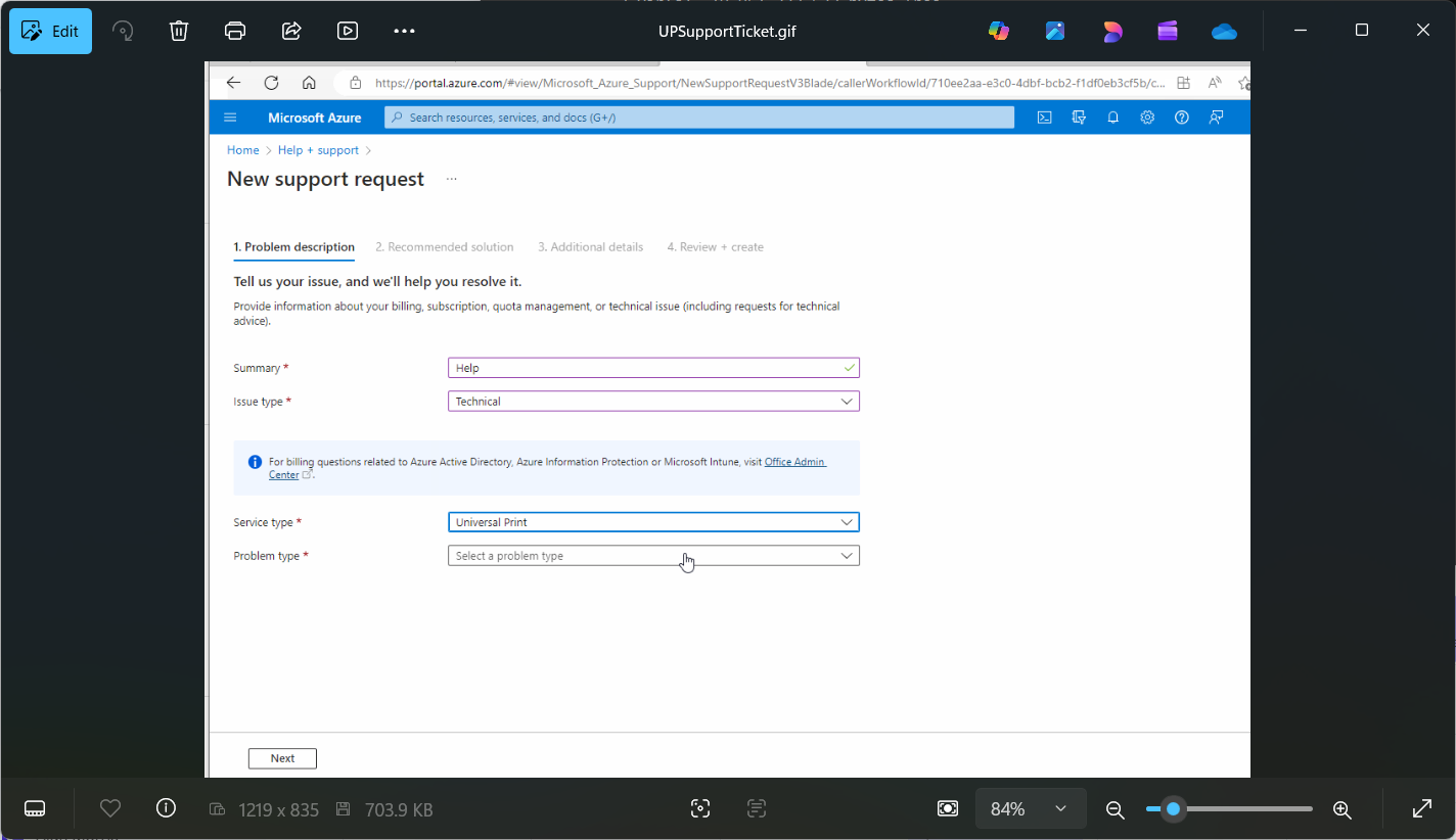

    @RFHelp0 did someone over in UP troubleshooting space help you on this?
    Thanks
