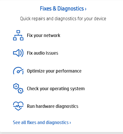

    Hi,try downloading https://support.hp.com/gb-en/help/hp-support-assistant HP Support Assistant (it has more tools)
