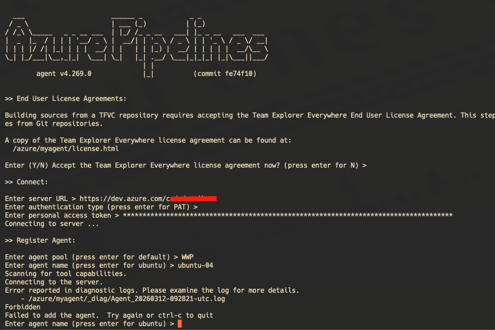

Steps
  1. Download agent
  2. Run ./config.sh
  3. Enter organization URL
  4. Enter PAT
  5. Select agent pool

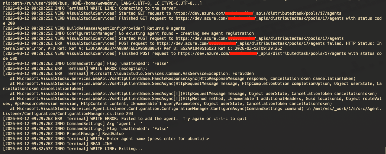

The agent configuration fails with the following error:
Forbidden
Failed to add the agent.
Diagnostic logs show:
Started GET request to https://dev.azure.com/<org>/_apis/distributedtask/pools/17/agents
Finished GET request with status code 200
Started POST request to https://dev.azure.com/<org>/_apis/distributedtask/pools/17/agents
POST request failed with HTTP Status: 500
Exception:
Microsoft.VisualStudio.Services.Common.VssServiceException: Forbidden
Observations
  • GET request works (200)
  • POST request fails (500 + Forbidden)
  • PAT has Full Access
  • Agent pool exists
  • No existing agent in the pool
Question
Why would Azure DevOps allow GET but reject POST when registering a new agent?
Could this be related to agent pool permissions or organization policies?Screenshot 2569-03-12 at 16.32.03

    The agent is able to successfully authenticate and connect to the Azure DevOps organization, as indicated by the successful GET request (HTTP 200) to the agent pool endpoint. However, the registration step fails during the POST request used to add the agent to the pool, which returns Forbidden.
    This behavior typically occurs when the identity associated with the Personal Access Token (PAT) has permission to view or use the agent pool, but does not have sufficient permissions to register or manage agents in that pool.
    Although the PAT is configured with Full Access, PAT scopes do not override Azure DevOps role-based access control (RBAC). The user who created the PAT must also have the appropriate Agent Pool permissions within the organization.
