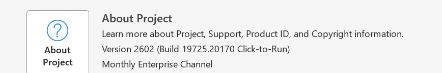

    Which version/build of MS Project are you using (You can check by Open Project > File > Account > About Project)?

    • Which version/build of MS Project are you using (You can check by Open Project > File > Account > About Project)?

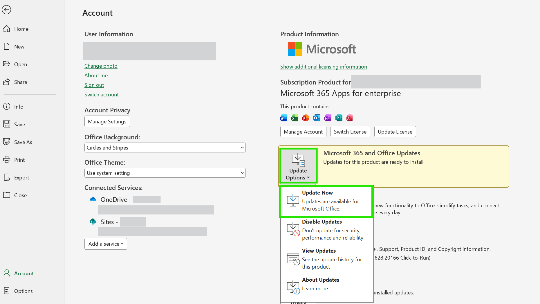

    • Install the latest Office updates, as crashes and unexpected closures can occur on outdated builds: Open any Office app (Word, Excel,...) > File > Account > Update Options > Update Now.   User's image

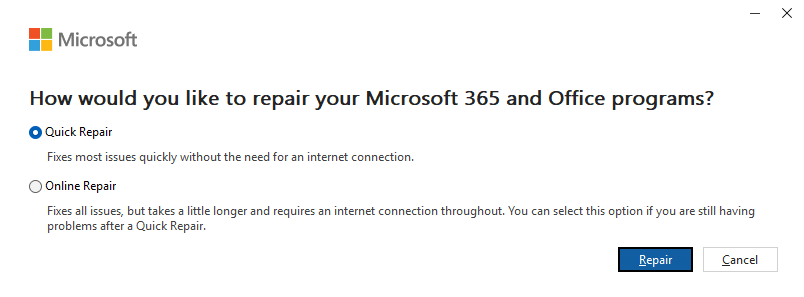

    • Perform an Online Repair of Microsoft 365/Office. This helps fix corrupted components that may cause Project to close unexpectedly.
      • Close all office apps completely.

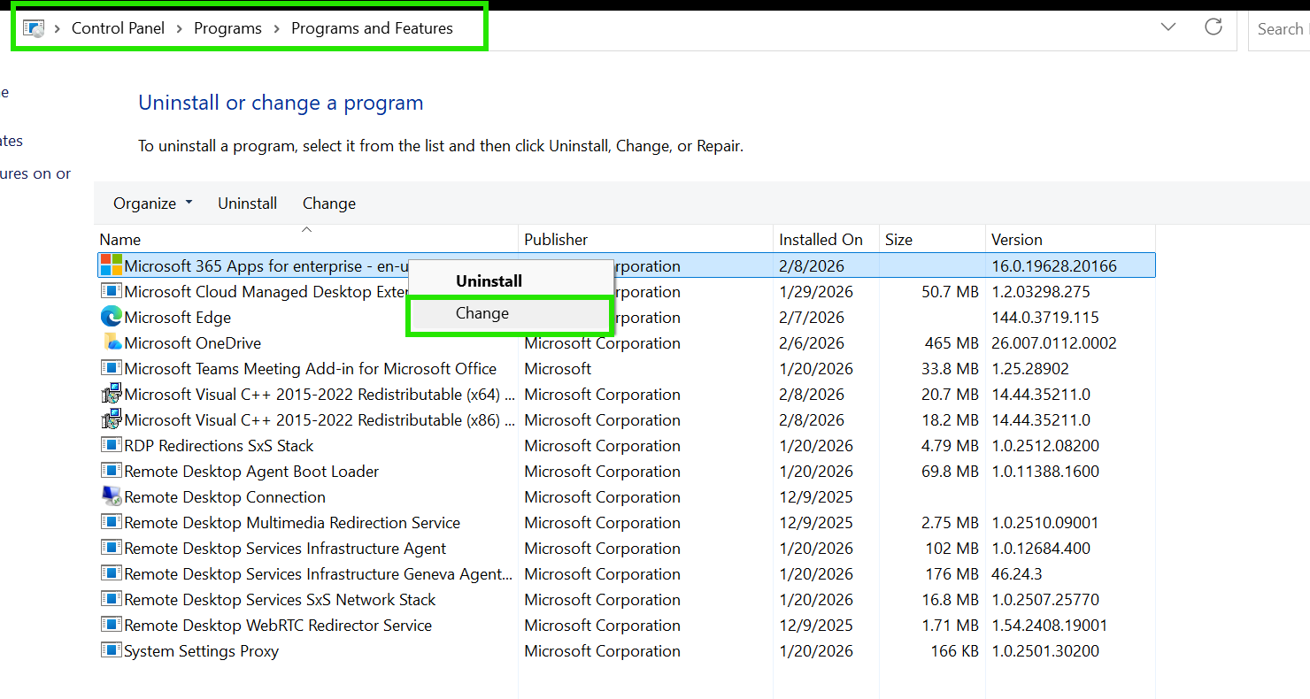

      • Go to Control Panel > Program > Programs and Features
      • Right click on the Microsoft Office you've installed > Change.
      • Select Quick Repair first (fast and doesn’t require internet).    User's image
      • If the issue persists, run Online Repair (requires internet and takes longer).
