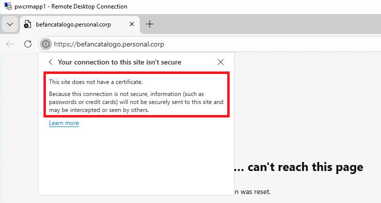

This site does not have a certificate!!!.
Lucas Peñaloza 421 Reputation points
2026-03-13T04:01:06.57+00:00
Dear All,

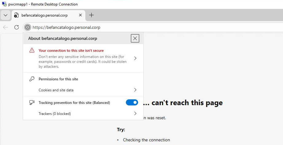

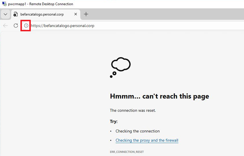

I am trying to understand the following screenshot.
We have the certificates installed!!!
Look;
What could be wrong?

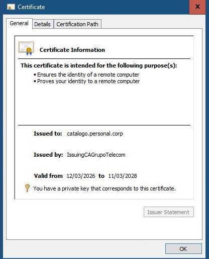

In the certificate;
Subject Alternative Name
DNS Name=catalogo.personal.corp
DNS Name=befancatalogo.personal.corp
DNS Name=pwcrmapp1.personal.corp
DNS Name=pwcrmapp2.personal.corp
DNS Name=pwcrmapp3.personal.corp
DNS Name=pwcrmapp4.personal.corp
IP Address=10.75.69.61
IP Address=10.75.69.62
IP Address=10.75.69.63
IP Address=10.75.69.64

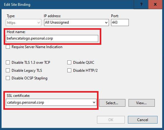

    From the screenshots and the certificate details you’ve shared, the issue is not with the certificate itself but with how IIS is binding it to the site. The certificate clearly contains the correct Subject Alternative Names for befancatalogo.personal.corp and the other hostnames, so the SAN coverage is fine. The problem lies in the HTTPS binding configuration.

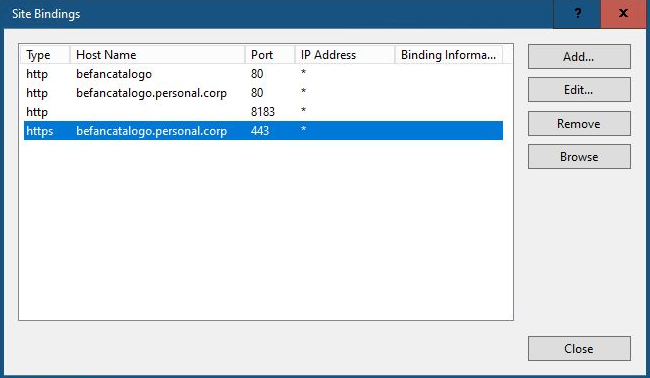

    In IIS, the binding for befancatalogo.personal.corp is set to HTTPS on port 443, but the certificate selected is catalogo.personal.corp. Even though the SAN includes befancatalogo.personal.corp, IIS requires the binding’s hostname to match the certificate subject or SAN exactly. If the binding is not configured with “Require Server Name Indication (SNI)” checked, IIS will not correctly serve the certificate for that hostname, and clients will see the “connection reset” or “not secure” warning.
    To fix this, you need to edit the HTTPS binding for befancatalogo.personal.corp and ensure that:
    The SSL certificate selected is the one that actually contains befancatalogo.personal.corp in its SAN (which you already have).
    The “Require Server Name Indication” option is enabled if multiple hostnames are bound to the same IP/port. Without SNI, IIS will only serve one certificate for all hostnames, which causes mismatches.
    After applying, restart IIS (iisreset) to flush the binding cache.
    If you are still seeing ERR_CONNECTION_RESET, that usually indicates the TLS handshake is failing. This can happen if the client rejects the certificate because the binding is serving the wrong one, or if there is a mismatch between the hostname requested and the certificate IIS is presenting. Double-check that the binding for befancatalogo.personal.corp is explicitly configured with the correct certificate and that SNI is enabled.
    In short: the certificate itself is fine, but IIS is not serving it correctly for the requested hostname. Adjust the HTTPS binding with SNI enabled and the correct certificate, then retest the connection.

    The browser message means the TLS handshake is failing before a certificate can be presented, even though a certificate is installed in IIS. The issue is typically with how the certificate is bound or trusted, not with the browser itself.

    3. Validate the HTTPS binding and HTTP.sys registration
      • In IIS, the binding screenshot shows https on port 443 with host name befancatalogo.personal.corp and certificate catalogo.personal.corp. That is correct as long as the SAN list includes befancatalogo.personal.corp (which it does).
