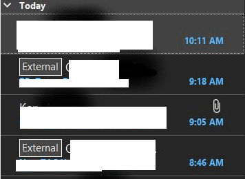

Suddenly the other day everyone got the External tag applied to outside emails. I went in and confirmed it was not on via PowerShell, disabled it, but the next day it was enabled again. Every time it is turned off it shows enabled again by the next day. We did not make any policy changes or other adjustments to our tenant prior to this suddenly starting. I have tried to locate some sort of policy in Defender or Exchange that may be enforcing it but have not had any luck.

    Can you please confirm if you are seeing the External tag like this?
    For the temporary solution, if you are using Classic Outlook, you can follow the steps here to hide it. Remove “External” tag from Outlook Message List - Robert 365
    I know this is not a definite solution, but meanwhile figuring this out, please use it as an alternative.
