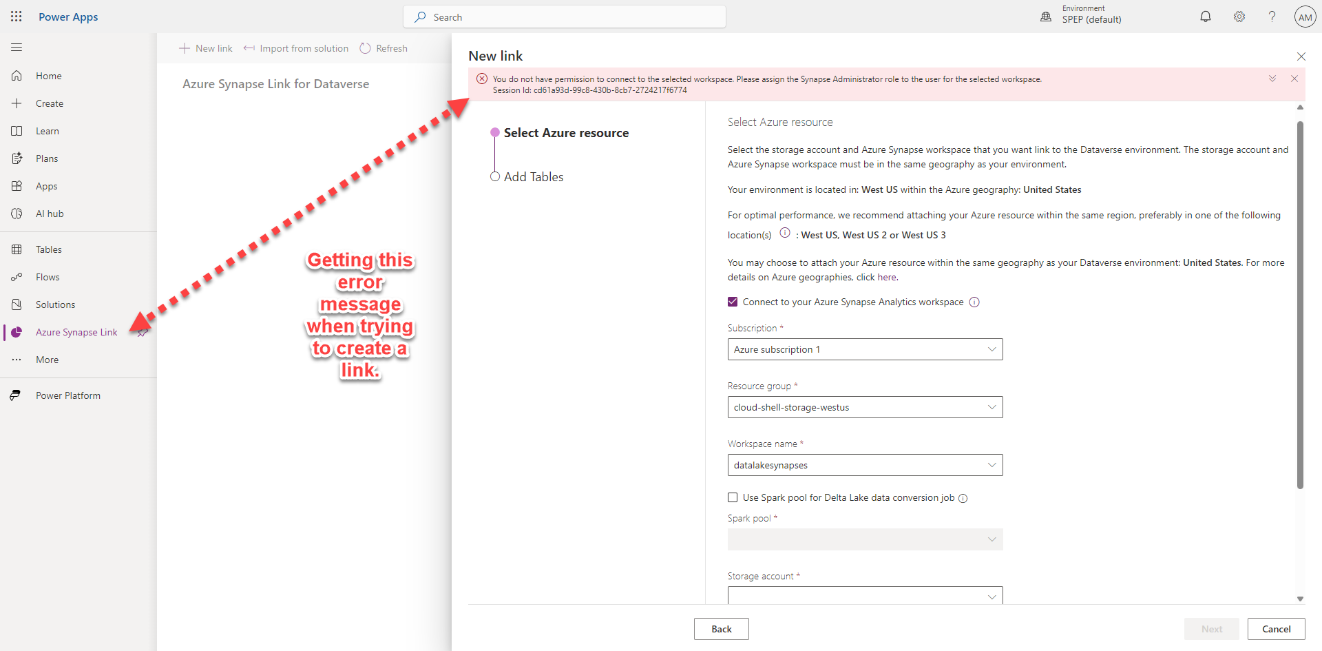

failed to load one or more resources due to forbidden issue, error code 403.

Im getting an error message when trying to create a azure synapse link from power apps.

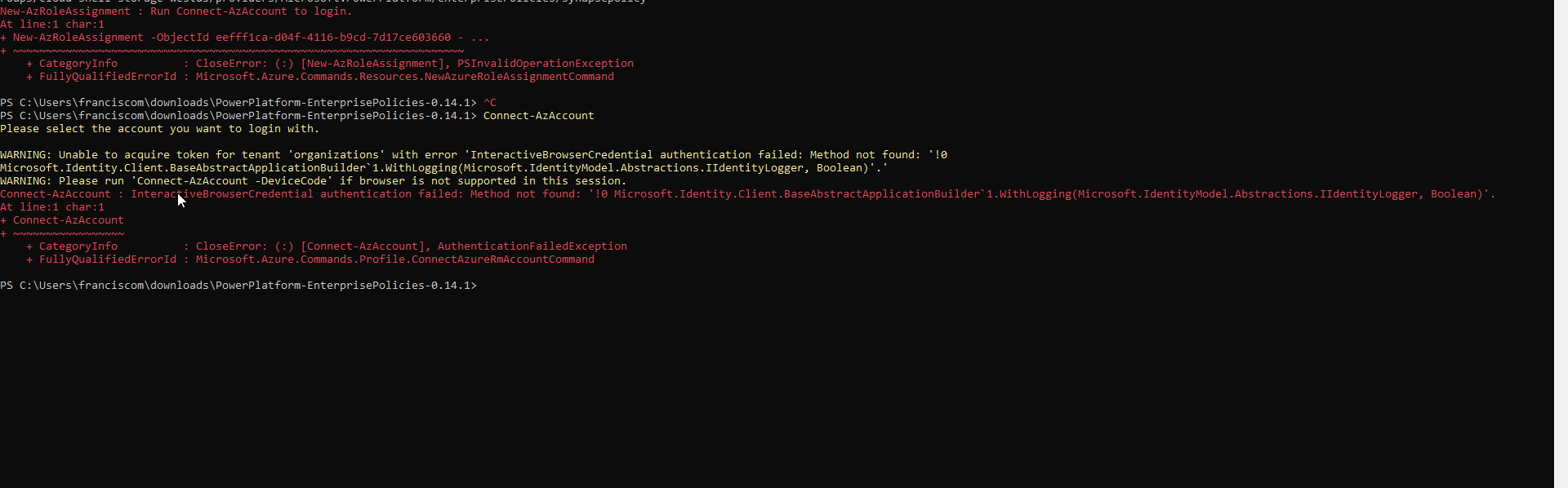

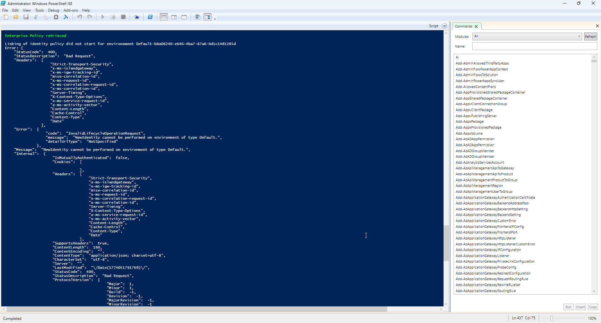

    Actually I was able to make it work..! Looks like I had to click on ADD client IP as it doenst automatically do it for you!. Now Im getting another issue.
    The selected storage account has restricted network access. To proceed, please setup an enterprise policy and connect it to your Dataverse environment. Once done, please enable the 'Select Enterprise Policy with Managed Service Identity' option below. For detailed instructions, please visit: https://learn.microsoft.com/en-us/power-apps/maker/data-platform/azure-synapse-link-msi

  3. Pilladi Padma Sai Manisha 6,665 Reputation points Microsoft External Staff Moderator
    2026-03-13T20:48:33.5333333+00:00
    Hi Application Manager SPEP,
    Thankyou for reaching microsoft Q&A!
    The 403 – Forbidden error typically occurs when the user creating the Azure Synapse Link for Dataverse does not have sufficient permissions on the required Azure resources.
    To create the link successfully, please ensure the following permissions are configured:
    The user must be assigned Synapse Administrator or Synapse Contributor role on the Azure Synapse workspace.
    The user must also have Storage Blob Data Contributor (or Owner) access on the associated Azure Storage account used by Synapse.
    Verify that the user has the required Power Platform / Dataverse permissions, such as System Administrator or equivalent role in the Dataverse environment.
    Ensure the Synapse workspace and Dataverse environment are in supported/compatible regions, as cross-region configurations can sometimes block link creation.
    If the Synapse workspace or storage account has network restrictions or firewall rules enabled, confirm that the Microsoft services / trusted services option is allowed so Power Platform can access the resources.
    After validating and updating these permissions, sign out and sign back into Power Apps and attempt to create the Synapse link again.
    If the issue persists, please share the workspace name, storage account name, and confirmation of the assigned roles so we can further investigate.
