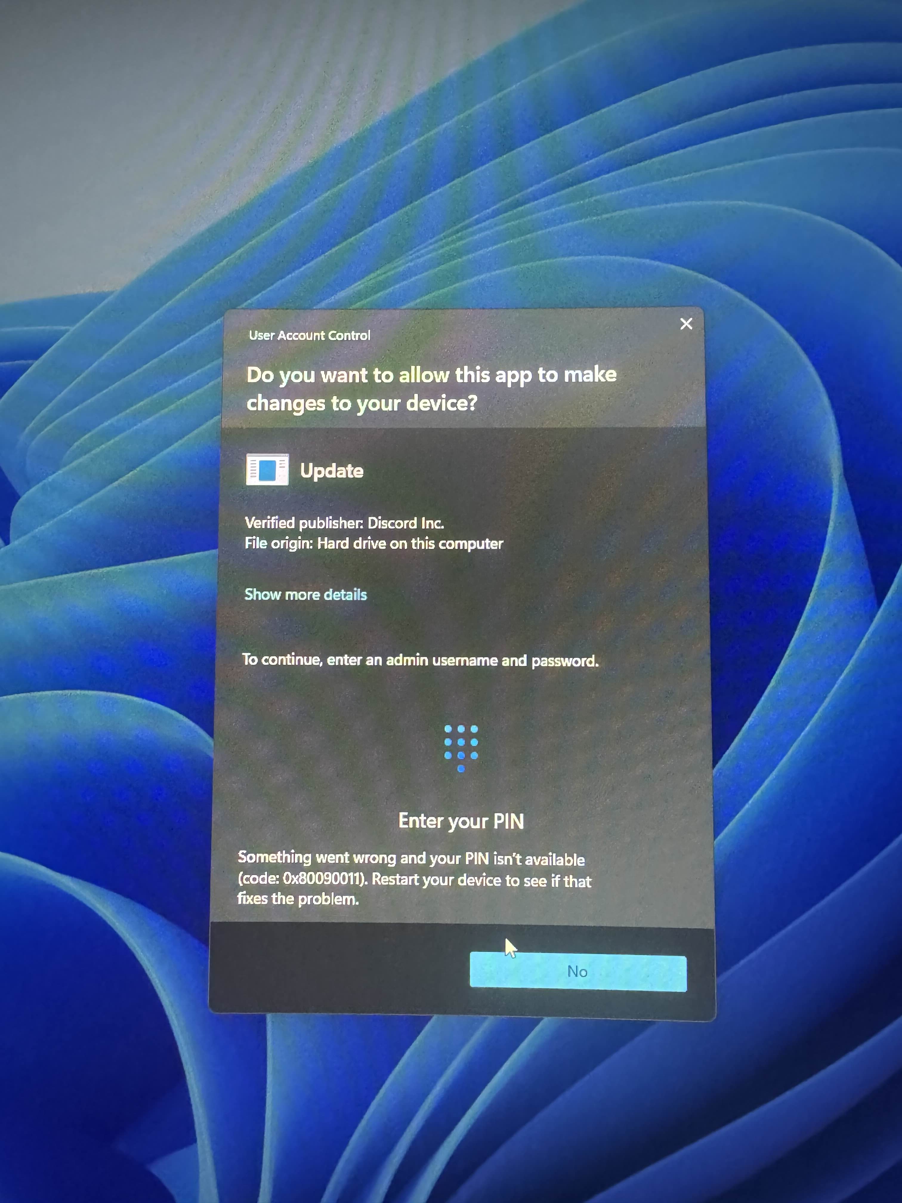

hello guys , since yesterday ive been getting this weird error code when trying to put my pin when installing something or opening apps in administrator mode, i literally removed the pin from the setting it says "set up" and restarted my pc and it still give me this error and cant install anything

    The error 0x80090011 indicates that the Windows Hello PIN credential data is corrupted. When this happens, Windows cannot use the PIN for sign‑in, administrator approval, or app installation, even if the PIN shows as “Set up” in Settings.

    Error code 0x80090011 during PIN use or creation indicates that the Windows Hello key container or key was not found. The PIN configuration is corrupted and must be rebuilt.
