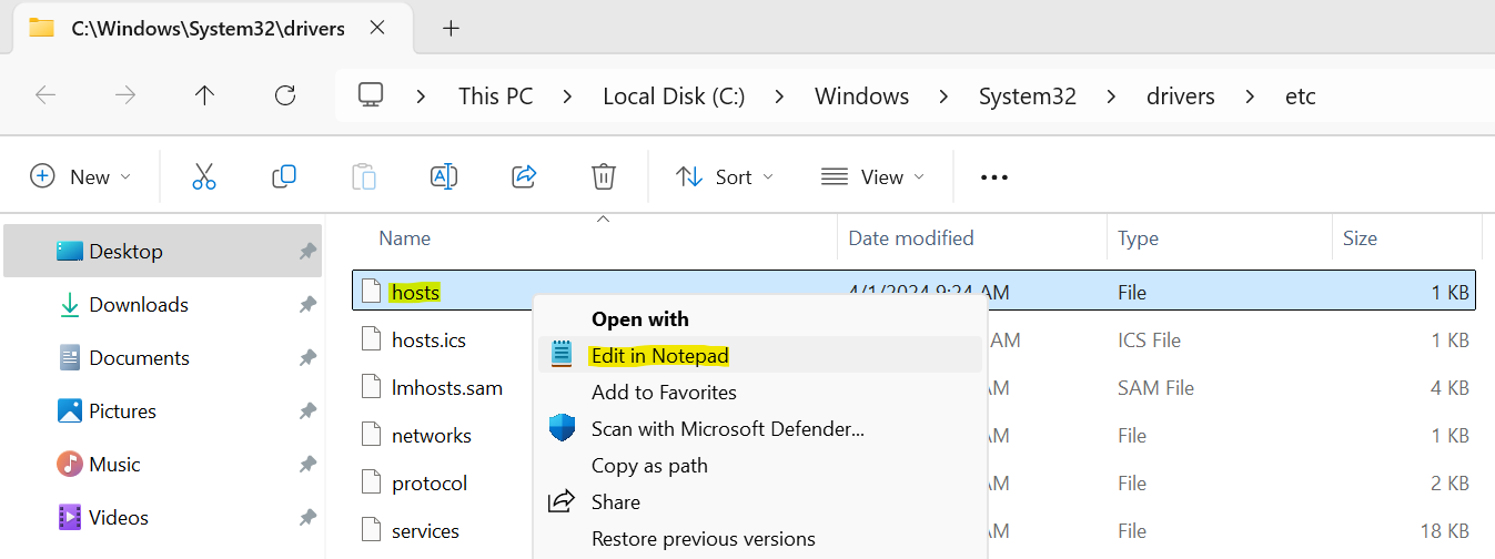

    I would like you to check out the (hosts file) on your windows:
    go to (C:\Windows\System32\drivers\etc)
    Brief: hosts file act as 1st DNS for your machine like (hard coded phone book).
    Example: http://www.dontaskwhy.com/ = 1.2.3.4 (IP) even you have a proper google DNS 8.8.8.8 it will redirect you to 1.2.3.4
    Example 2: if i set (google.com = 0.0.0.0), you will not be able to access google as it has wrong ip (think of it as it's a phone contacts app and you have to register your friend's phone number correct to be able to dial it)
    P.S: we will need (Administrator Account) to modify it.

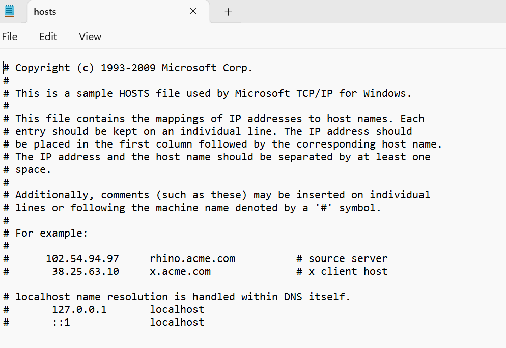

    • That's the default hosts file (note: it's all start with hashes(#) > this means it's a comment and not real (it's only for example)
    I want you to look for any values added and delete them ALL > Save the hosts file on the same location (File > Save > Replace)
    You might need admin account so open (NotePad as administrator & open the hosts file again to save it)

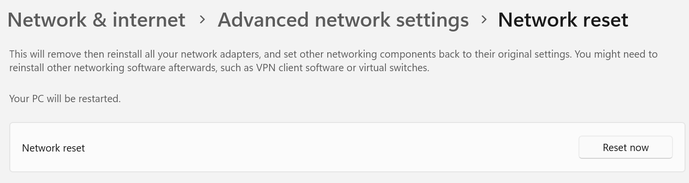

    7. Lastly, launch a network reset from settings
      (Settings > Network & internet > Advanced network settings > Network reset) > your pc will restart

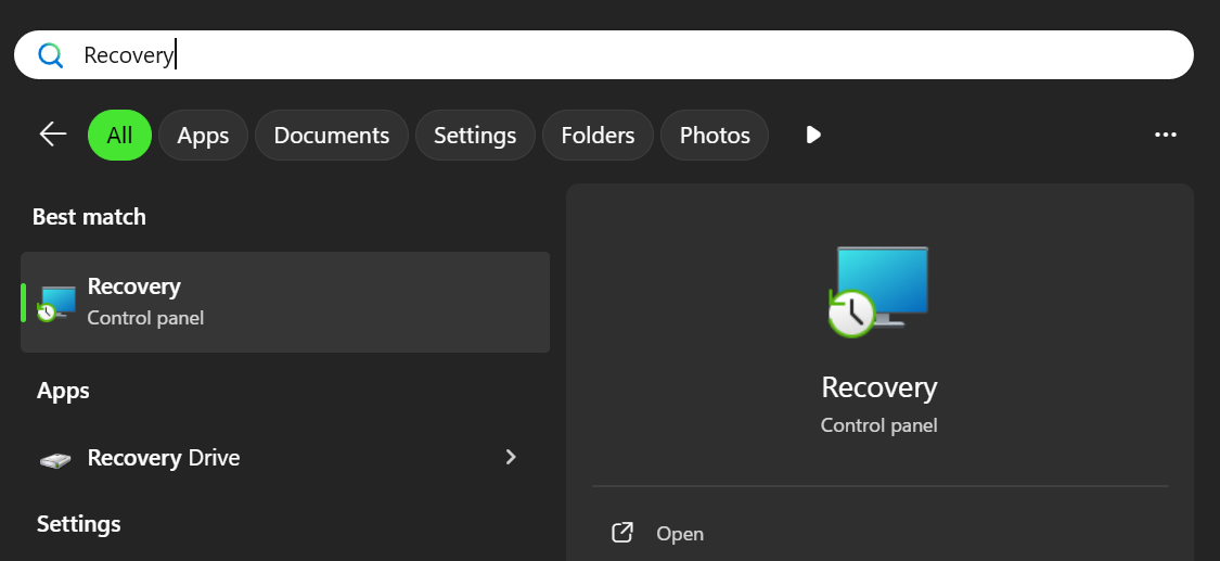

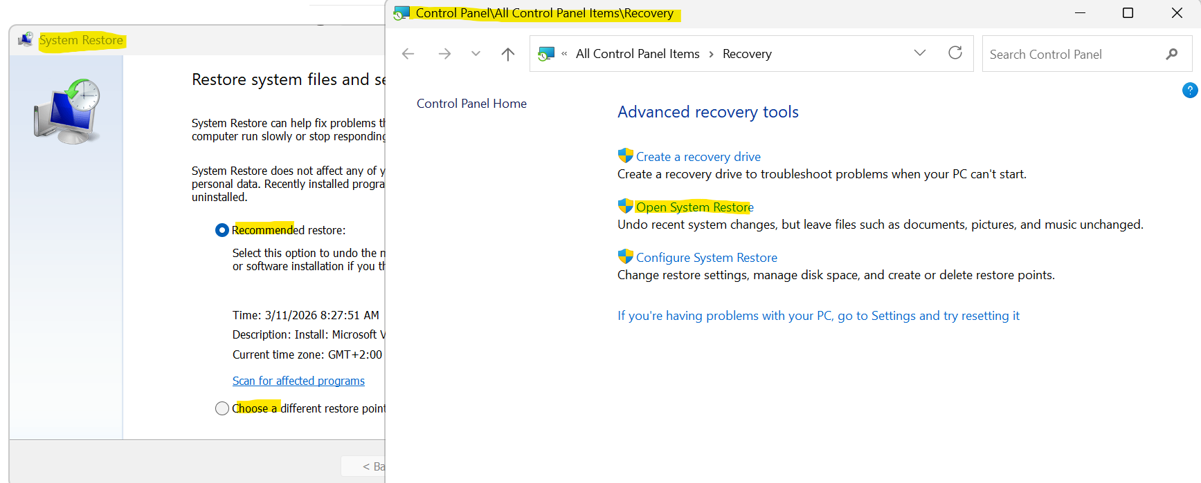

    Pro Tip:
    There is a tool called (System Restore) // what it actually does it's taking a backup of your settings/configurations (don't worry it's not affecting your files)
    it's a life saver ;)
