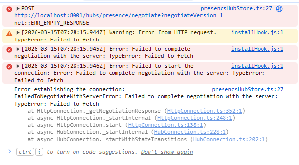

Screenshot 2026-03-15 142830
When connecting to the hub, I get the error shown in the image. I don't know what I did wrong. Please help me.

    This error happens on the SignalR negotiate request:
    POST http://localhost:8001/hubs/presence/negotiate?... net::ERR_EMPTY_RESPONSE
    So the gateway is not returning any HTTP response (wrong route or the proxy can’t forward the request correctly).

    The browser log shows the SignalR client failing on the /negotiate call with net::ERR_EMPTY_RESPONSE, which means the gateway is not returning a valid HTTP response for POST http://localhost:8001/hubs/presence/negotiate?negotiateVersion=1.

    3. Capture and inspect the traffic
      • Use browser network tools or a network trace (for example, Fiddler or the browser’s Network tab) to see what response the gateway returns for /hubs/presence/negotiate.
      • In a working setup, /negotiate should return JSON with a connection ID and available transports. An empty response or connection reset indicates the gateway is not forwarding correctly or the backend is failing before responding.
