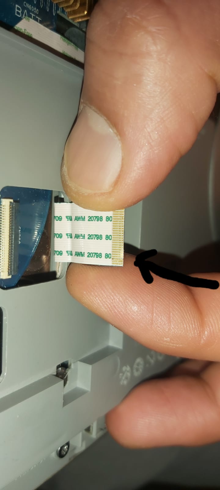

Multimedia button cable.jpegHello, I have an HP ProBook 650 G2 laptop. Yesterday, March 14, 2026, I installed an update to Windows 10 Pro 22H2 (KB5078885). The installation was successful. I shut down the laptop, and after a while, I restarted it as usual, but it didn't work. I suspected the problem was with the RAM. I have two RAM modules: one is an Adata 8GB DDR4 at 2400MHz, and the other is a Samsung 4GB DDR4 at 2666MHz. I was surprised to find that the Samsung RAM stopped working. I tried changing the channel and replacing the RAM, but the problem was with the Samsung RAM. I opened the laptop, cleaned it thoroughly, and reassembled it, but the problem persists. I tried checking the BIOS settings, performing a factory reset, and completely unplugging the laptop, but the problem remains. My RAM is Samsung. I checked my RAM for any faults or defects and noticed a minor issue with its pins, which I fixed. However, the problem persists. I then configured my router as usual before updating my computer.
Note: Over a week ago, I disabled Developer Options on my Samsung phone, and after this issue, I enabled them again.
But the problem still exists. The next day, I used my Samsung phone's camera to check the RAM for any defects. After that, the laptop booted up successfully using both Samsung RAM and A_Data memory. Now I want to know the cause of the problem and why I'm experiencing RAM issues after installing the Windows 10 Pro 22H2 update (kb5078885). Thank you. Note: I found a connector inside the laptop case. (Multimedia button cable +Smart Card scanner or input cable) This connector has a charging indicator, a battery charging indicator, and a system/hard drive power indicator. One of its pins was bent, angled, or twisted, or it might have been connected to an adjacent pin, which could have caused a problem with the motherboard. I have now repositioned it correctly.

  1. Mohamed Alismail 0 Reputation points
    2026-03-15T16:08:33.6566667+00:00
    Thank you, but I believe the following:
    1. It is advisable to use identical RAM modules (same size, speed, and manufacturer) to minimize compatibility issues.
    This is due to the device configuration and the laptop's chassis. Different electronic components result in different internal component configurations.
    This can lead to simultaneous component failure or overheating.
    1. Intermittent connection or installation problems. The Samsung module initially failed the POST test, then worked again after several attempts to remove and reinstall it, as well as manual handling.
    As I mentioned earlier, I narrowed the problem down to the internal components. Opening the chassis and thoroughly cleaning the internal components, while directing heat onto the motherboard and RAM, did not reveal any component issues. The problem lies in the RAM. The update (KB5078885) unexpectedly caused a burn-in on the motherboard's circuit board. Alternatively, the router settings could be the cause, specifically the power supply or the burn-out wattage from connected or nearby devices, which affected the laptop's boot process due to the default settings. However, to pinpoint the problem to one source, the burn-out wattage from nearby devices is the likely culprit.
