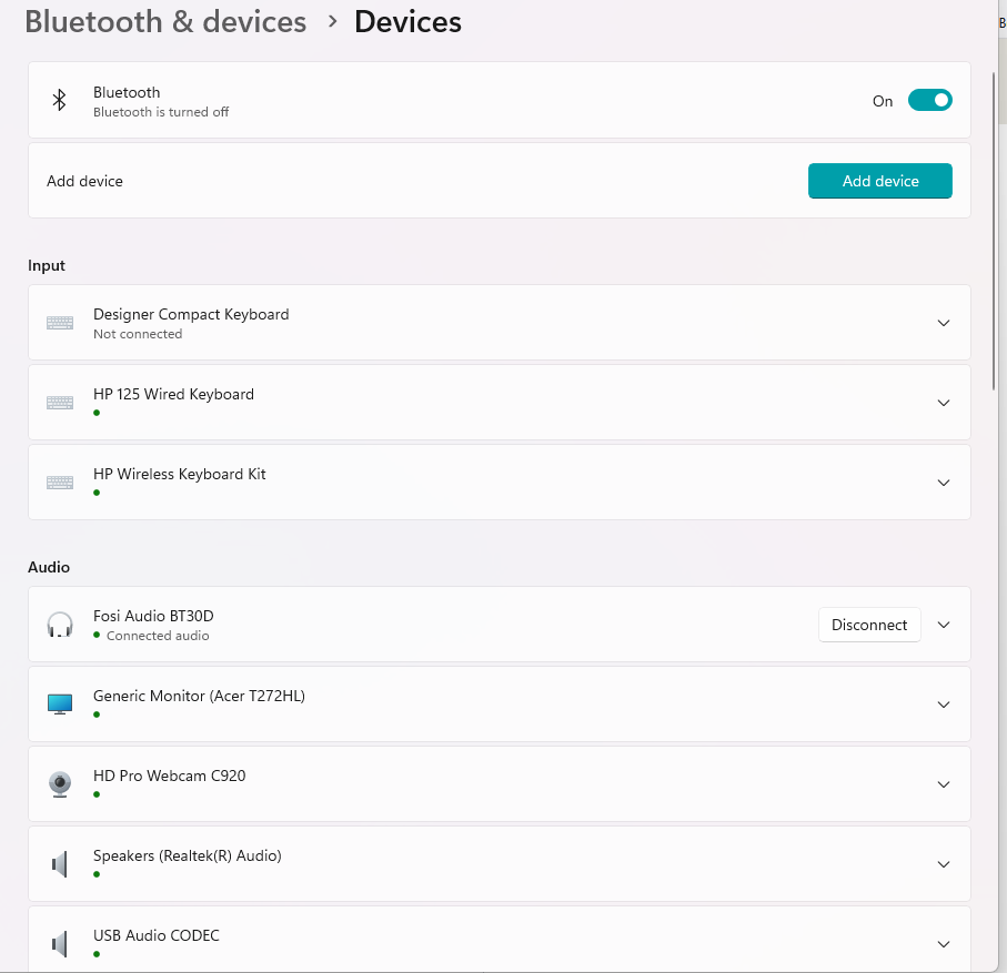

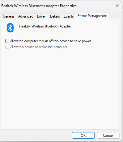

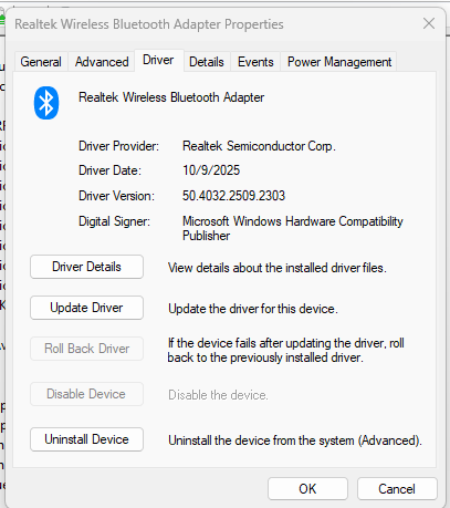

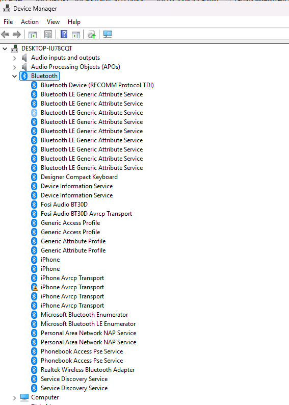

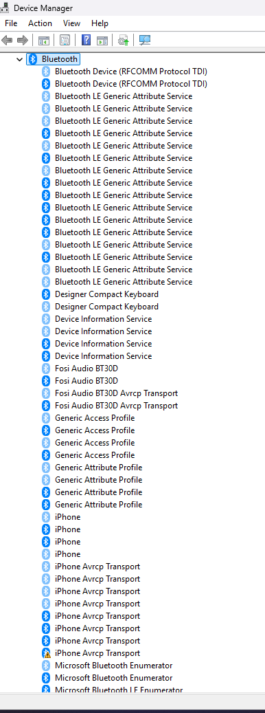

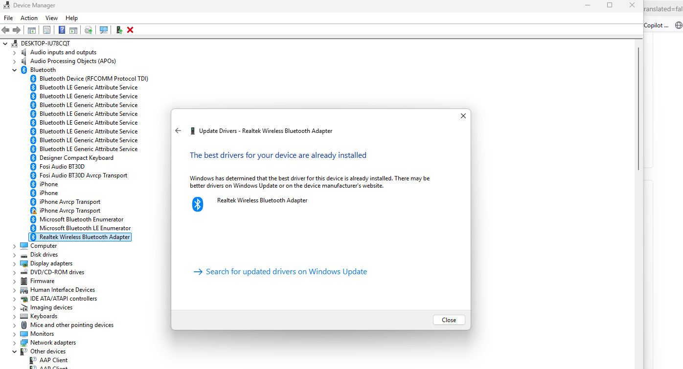

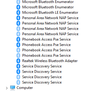

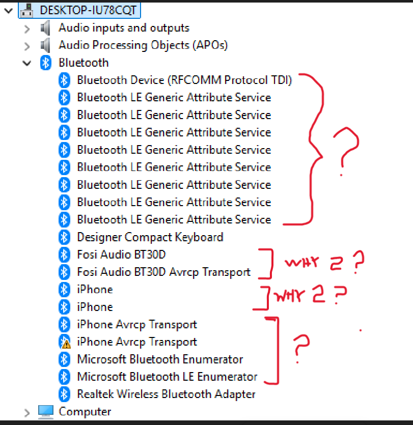

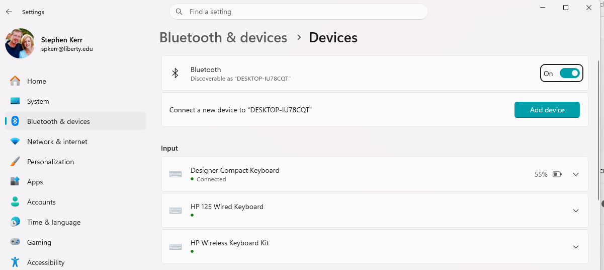

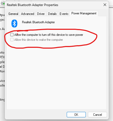

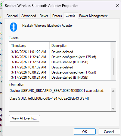

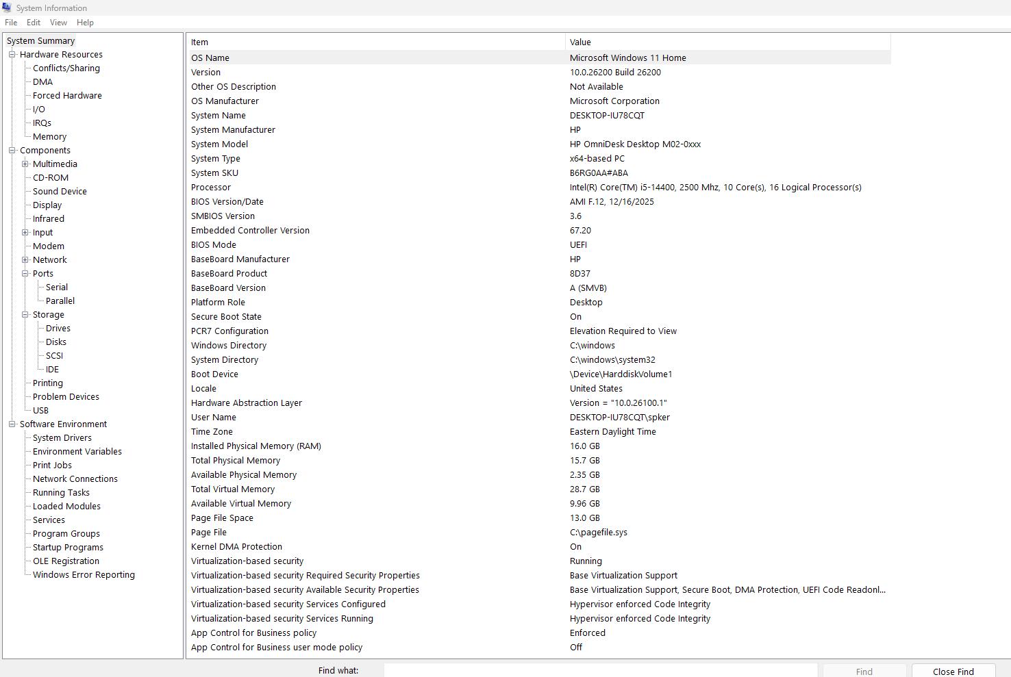

My bluetooth mouse via the HP Wireless Keyboard Kit works, but my Designer Compact Keyboard will not work. After attempts to reconnect, then after restarting my computer a few times, I can finally get the Computer Bluetooth to show the computer name and I can get the Designer Compact Keyboard to work again. The problem is rather erratic, and sometimes I can go for a few days before it fails to work again. I believe the problem is with the computer, not any of the devices. How can I fix this? Please see snips of the issue, my settings, device manager, and system info. Thank you.

    4. Reinstall the Bluetooth adapter driver
      1. Press the Windows logo key, type Device Manager, and press Enter.
      2. Expand Bluetooth.
      3. Select the main Bluetooth adapter (for example, Realtek or similar), then press Shift+F10 (or right‑click) and choose Uninstall device.
      4. Confirm Uninstall.
      5. Shut down the PC completely, wait a few seconds, then power it back on so Windows reinstalls the driver automatically.
      6. If it does not reinstall, open Device Manager, press Alt+A, and select Scan for hardware changes.

  2. Ivan B 105.3K Reputation points Independent Advisor
    2026-03-15T16:18:01.62+00:00
    First, remove the Bluetooth device and then turn off Bluetooth on your PC.
    Next, download the chipset and Bluetooth drivers from the links below:
    https://ftp.hp.com/pub/softpaq/sp165501-166000/sp165739.exe
    https://ftp.hp.com/pub/softpaq/sp165501-166000/sp165646.exe
    https://ftp.hp.com/pub/softpaq/sp165501-166000/sp165648.exe
    https://ftp.hp.com/pub/softpaq/sp165501-166000/sp165740.exe
    After installing these drivers, open the command prompt (admin) and run the following command: sfc Run /scannow and dism /online /cleanup-image /restorehealth, wait for the process to finish, and restart your computer.
    Then perform a clean boot and uninstall any unused applications you may need.
    [Link to Microsoft support page: https://support.microsoft.com/en-us/topic/how-to-execute-a-simple-boot-start-in-windows-da2f9573-6eec-00ad-2f8a-a97a1807f3dd]
    Turn Bluetooth back on. Click "See more devices," scroll down, go to "More Bluetooth settings," and check the option "Allow Bluetooth devices to find this PC" and apply.
    Then pair again and test.
    The links provided are drivers for your desktop model from HP
    https://support.hp.com/br-pt/drivers/hp-omnidesk-desktop-pc-m02-0000i/model/2102686309?sku=B6RG0AA
