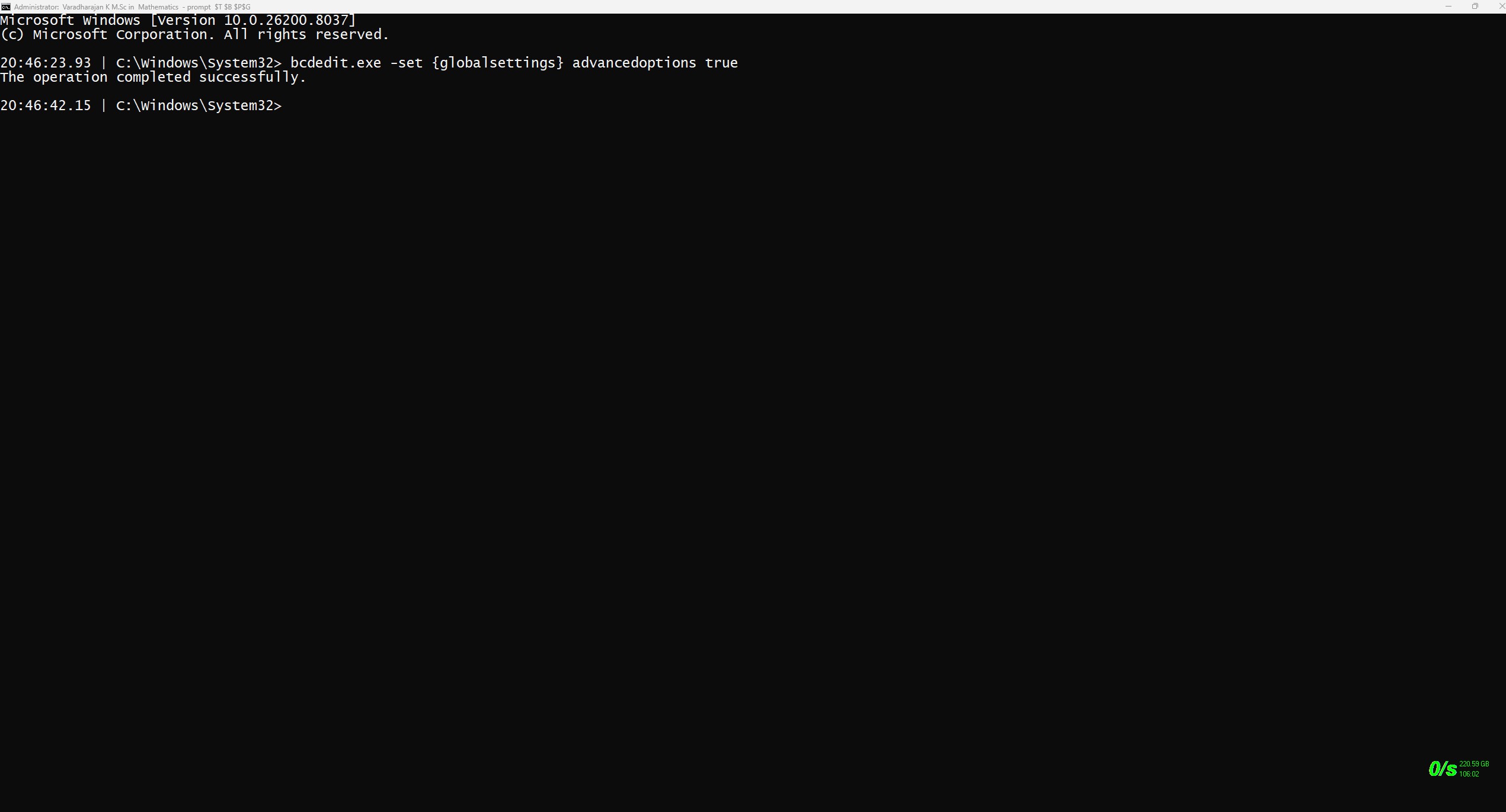

You must modify BCD , open cmd with administrator rights, and type the following
Bcdedit.exe -set {globalsettings} advancedoptions true
Restart Windows

To revert back to normal access mode
Login in to windows
Bcdedit.exe -set {globalsettings} advancedoptions false
