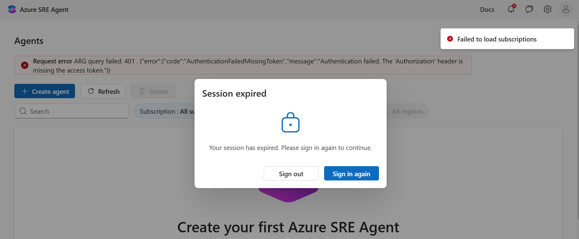

An Azure SRE agent was created from our end but while accessing it, it failed to get signed in. And we are not able to fetch subcription details on the SRE agent, even the owner of the account is also unable to fetch the subscription details. Due to that, the agent is not getting configured properly for use.
image (20)

    From what you’ve described, this doesn’t appear to be a service outage. The behavior is consistent with an authentication/token issue combined with missing RBAC permissions, which is preventing the SRE Agent portal from retrieving your subscription details.
    What’s happening
    The error “AuthenticationFailedMissingToken” indicates that the portal is not able to pass a valid access token while calling Azure Resource Graph (ARG).
    This is also aligned with the “Session expired” prompt you’re seeing, which means your current login session is no longer valid.

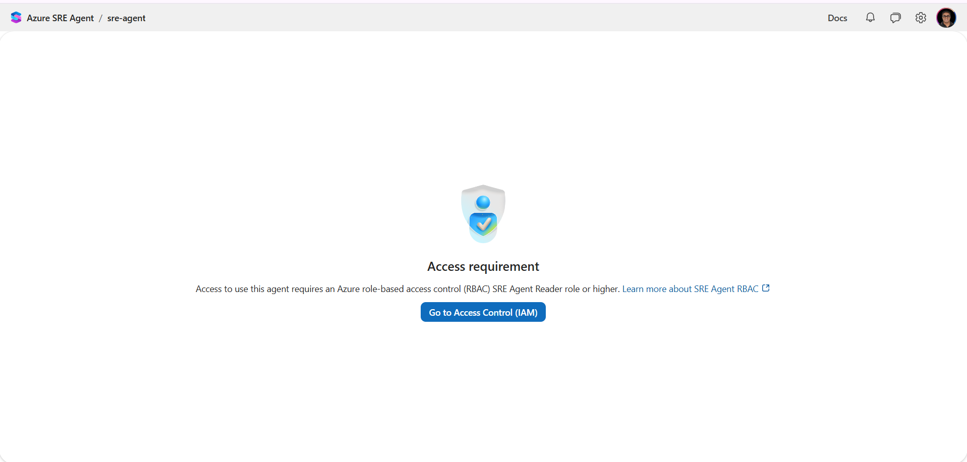

    In addition, the portal explicitly mentions that access requires the SRE Agent Reader role (or higher). Without this role, the portal will block access to agents and subscriptions—even if you are listed as a subscription Owner.

    1. Assign the required RBAC role
    • Navigate to the Subscription or Resource Group where the SRE Agent was created
    • Go to Access Control (IAM)Role assignmentsAdd role assignment
    • Search for “SRE Agent Reader”
    Assign this role to your user account
    Owner/Contributor roles do not automatically include this specific permission, so it must be explicitly assigned.
    Allow a couple of minutes for the role assignment to propagate.
    1. Refresh your authentication session
    Sign out of the Azure Portal completely
    Close the browser and reopen it (or use an InPrivate/Incognito window)
    Sign back in
    Also ensure Third-party cookies are allowed for the Azure portal, No browser extensions (privacy/ad blockers) are stripping authentication headers
