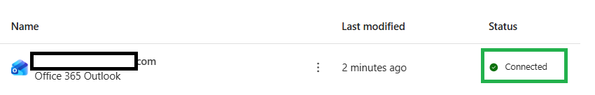

    1/ Refresh or recreate the email connection
    The most common resolution involves re-establishing the digital handshake between the services:
    • Navigate to More > Discover All > Connections under Data within Power Automate.
    • Locate the connection used by the email action and select Reconnect.
    • Alternatively, remove the existing connection and create a new one. Once updated, ensure the flow is pointed toward this refreshed connection and re-test the process.
      User's image Ensure the Status is always Connected.

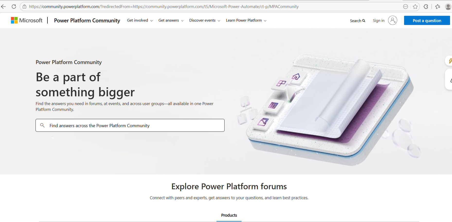

    Additionally, because this issue is often influenced by specific tenant governance and environment settings, I highly recommend engaging with the Power Automate Community. Experienced makers and specialists there can provide targeted advice on optimizing your notification patterns and navigating complex policy constraints.
    Moderator Note: Please be advised that as a moderator, I can provide general guidance and best practices based on standard documentation. However, I do not have direct access to your specific tenant, environment settings, or connection health to validate the exact root cause. If these adjustments do not resolve the error, involving your internal IT admin or the dedicated community forums is the most effective path forward.
