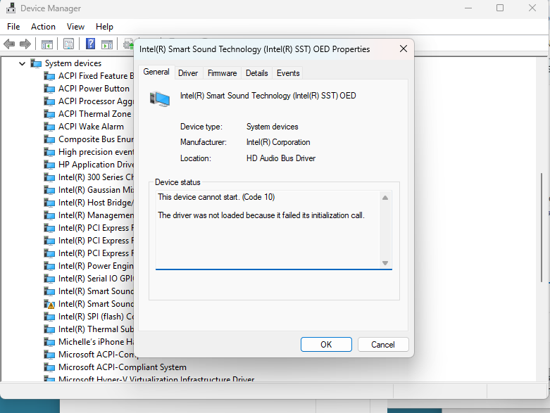

    If your keyboard and mouse work via Bluetooth, then Bluetooth itself is not the issue. The Bluetooth speaker relies on the audio drivers to function correctly, so the error with the audio driver is likely preventing it from connecting. By resolving the audio driver problem, the speaker should work as expected.
    In the meantime, I recommend testing audio through other available options. From what I understand, your device has built‑in speakers. Please try using them first. Once audio works through the built‑in speakers, you can then test again with the Bluetooth speaker. For this specific issue, testing with Bluetooth speakers can complicate the diagnosis and make it harder to identify the correct solution.
    I think it's a good idea to switch focus to the Realtek driver, since it's the primary audio driver for your device. The Intel SST often depends on it, so the error may be a side effect of the Realtek driver not working correctly.
    I suggest you reinstall the audio driver as instructed below.
    Download the latest audio driver from the HP website (link below), uninstall the current driver, restart your computer, and install the driver you downloaded.

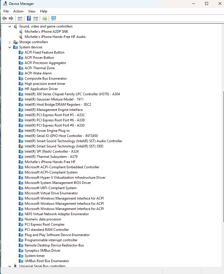

  1. David-M 109.5K Reputation points Independent Advisor
    2026-03-18T15:48:12+00:00
    No problem. Thanks for the screenshot.
    Code 10 is usually caused by a driver issue. But it can also be caused by hardware.
    I think it's a good idea to uninstall the device and let the system reinstall it automatically. In many cases, when this error occurs, that's enough to solve the problem.
    Uninstall the device by doing the following.
    1. Right-click on the "Intel(R) Smart Sound Technology (Intel(R) SST) OED" and select "Uninstall device";
    2. On the confirmation screen, check "Delete the driver software for this device" to delete the driver from the system;
    3. Restart (not shutdown) your PC.
    After restarting your PC, the driver should be reinstalled automatically.
    Check if the warning on the device has been resolved or if it will persist. If it is resolved, check if the sound and microphone will work.
    Please let me know how it goes.
    Feel free to ask any questions you may have.

    Open the Device Manager (Press "Windows + X" and select "Device Manager") and see if there are any devices labeled "Unknown Device" or with warning signs. Click the arrow to the left of each category icon to expand it and see the devices it contains.
    Share a screenshot of what you find.

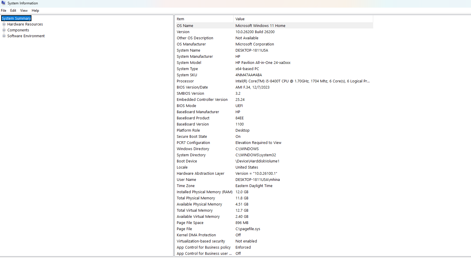

    Also. What is the manufacturer and model of your computer?
    If you prefer, you can share a screenshot of your system information.
    • Press "Windows + R", type msinfo32 and press Enter.
    Maximize the window and use the shortcut "Windows + Shift + S" to use the screenshot tool.
