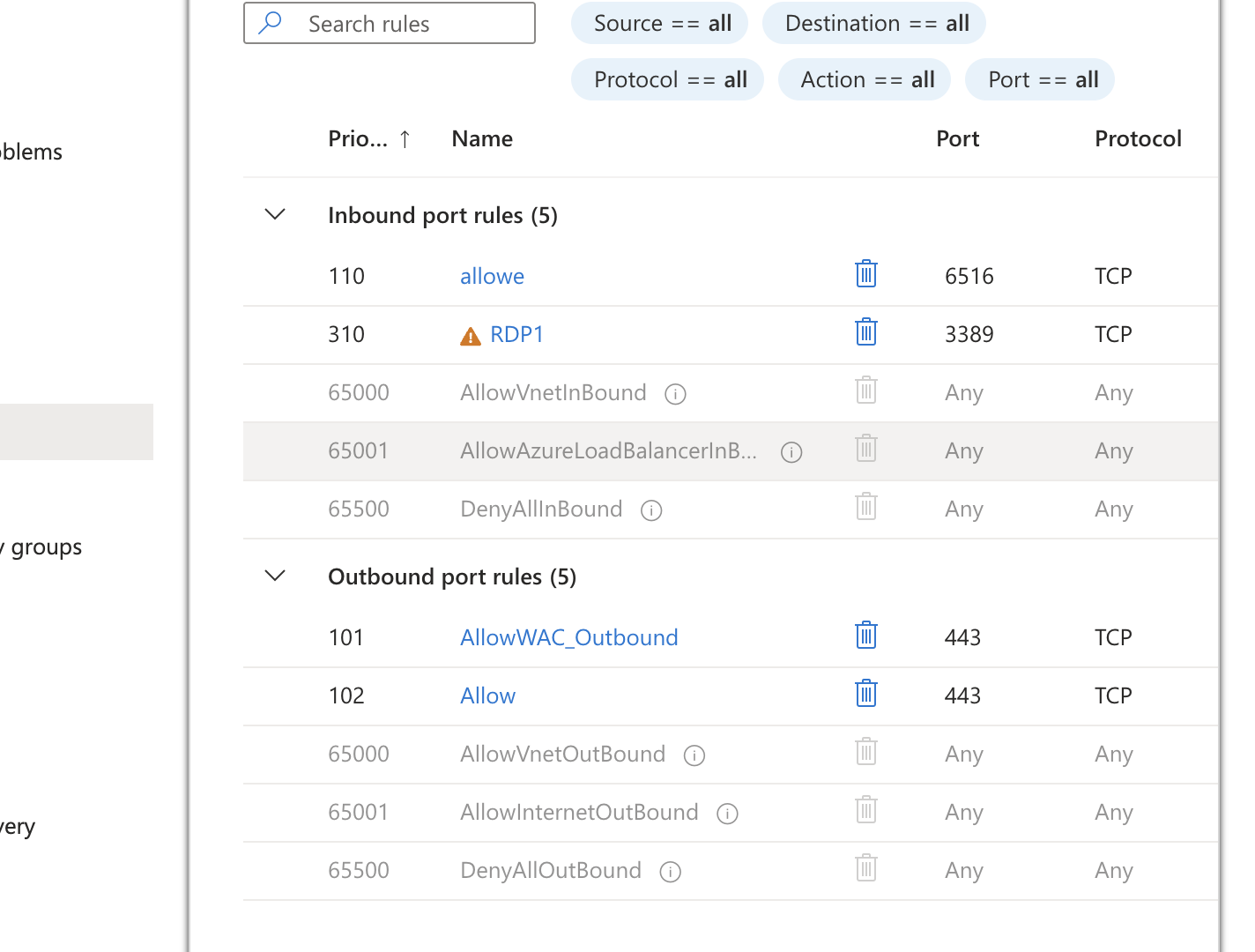

Network Security Group (Inbound): I have manually added an inbound rule for port 6516 for my specific source The Azure portal confirms VM access is "Configured."
Network Security Group (Outbound): I have manually added outbound rules for port 443 using the WindowsAdminCenter and AzureCloud service tags.

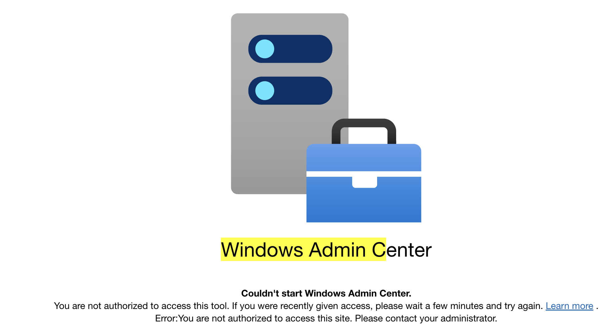

RBAC Permissions: I have assigned the "Windows Admin Center Administrator Login" role to my user account. When I attempt to re-add the role, the portal confirms the assignment already exists (ID:
Guest Account Status: My account is a Guest in this tenant (adminpenly advice(Guest)), but the role assignment is confirmed at the VM scope.

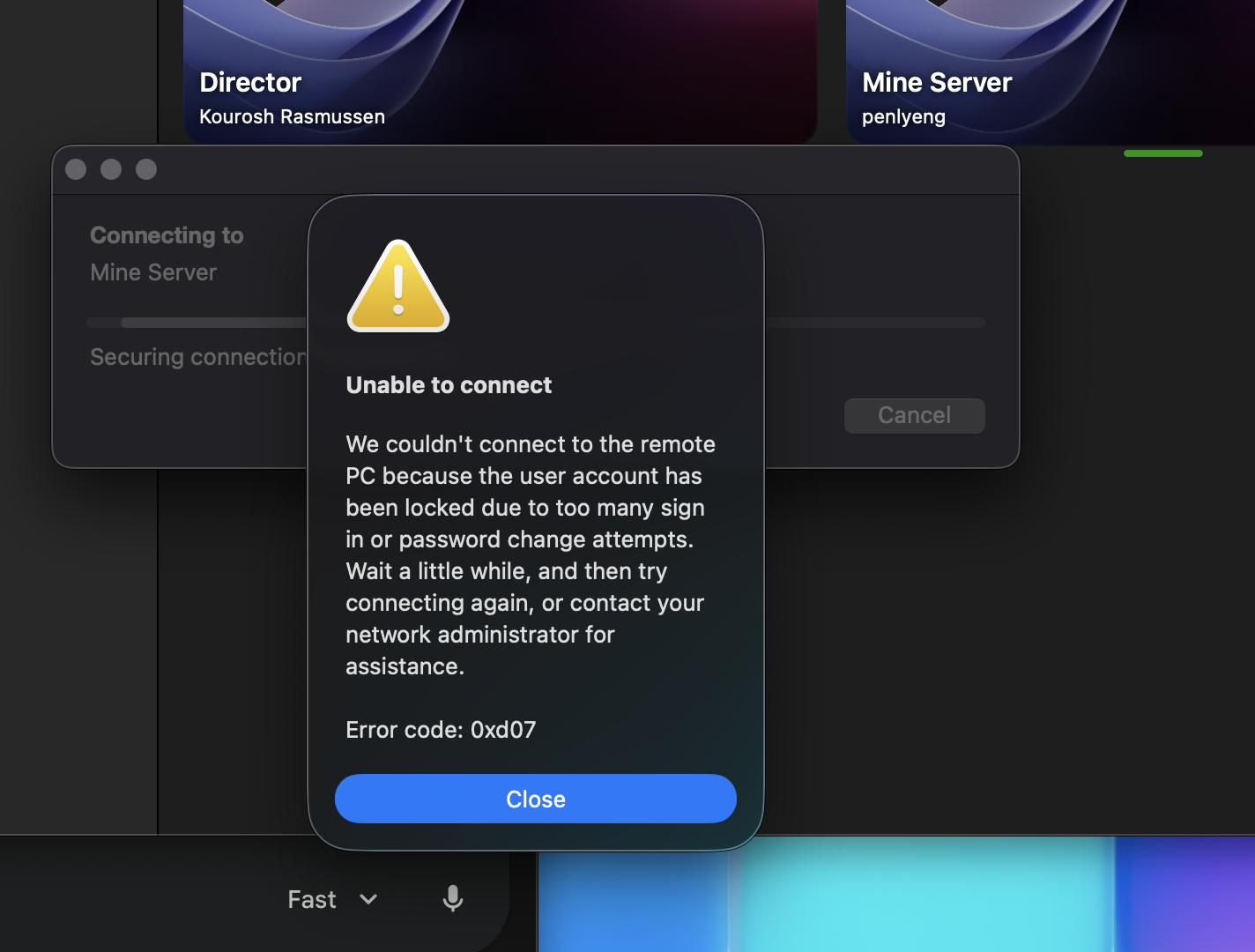

Account Lockout: I have performed a Password Reset via the portal to ensure the user account is not locked (Error 0xd07 was previously observed but cleared).

Portal UI: Shows "You are not authorized to access this site" even after logging out and back in.

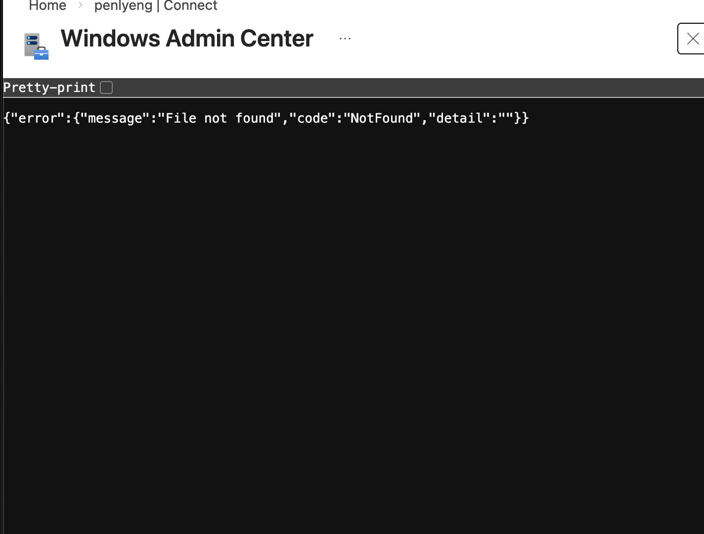

Previous JSON Error: Intermittently received {"error":{"message":"File not found","code":"NotFound"}} when the WAC blade attempts to load.

    Based on the investigation and observed behavior, this issue is not related to missing NSG rules or an incorrect role configuration. The Windows Admin Center Administrator Login role has already been assigned correctly at the virtual machine resource scope, and the duplicate assignment message confirms that RBAC is functioning as expected.
    The behavior you are encountering aligns with a known limitation in how Windows Admin Center handles identity authorization and extension validation in Azure. Specifically, when Windows Admin Center is accessed using a Guest (external) Microsoft Entra ID account, the extension may fail during token validation even though RBAC permissions are correctly configured. This can result in errors such as:
    • “You are not authorized to access this site”
    • Intermittent “File not found (NotFound)” or JSON load errors in the WAC blade
    Additionally, the “Failed to configure outbound port rule” message observed in the Azure portal is a known portal-side validation behavior. This message does not necessarily indicate a real network connectivity issue and can appear even when outbound HTTPS (port 443) access is already allowed through existing NSG rules or default Azure networking configurations
    To resolve this issue, we recommend using a member (non-Guest) Microsoft Entra ID account, as this is the supported and more reliable approach for Windows Admin Center access. Please update the user type from Guest to Member in Microsoft Entra ID (this action requires appropriate administrative permissions), allow time for the change to propagate, and then sign out of all active sessions before attempting to reconnect from the Azure portal.
