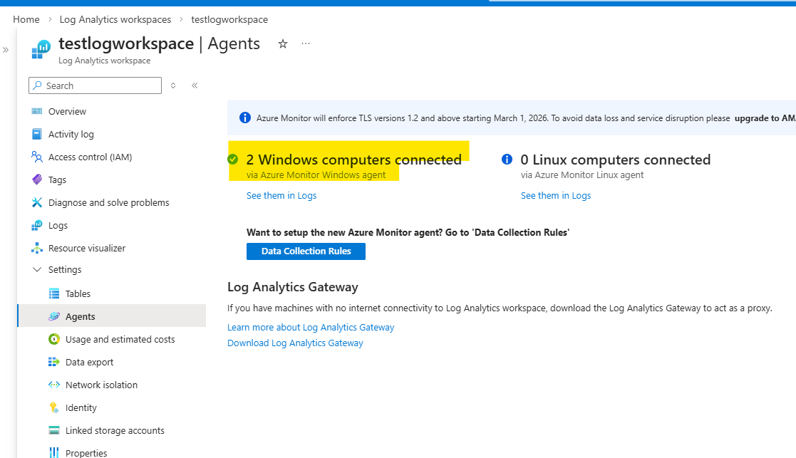

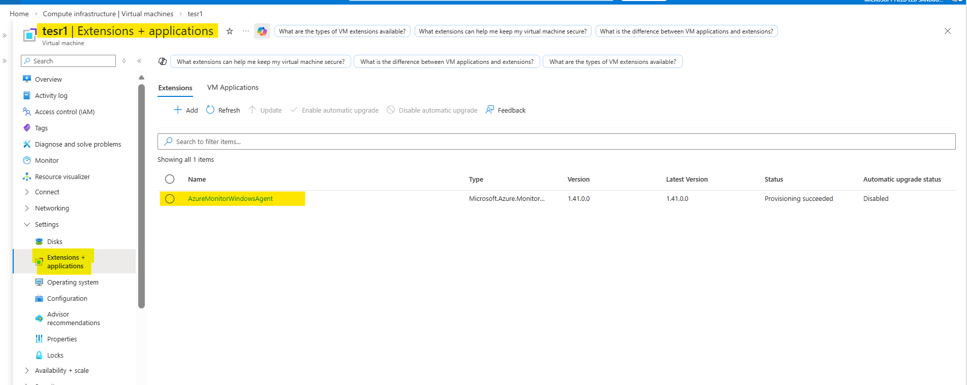

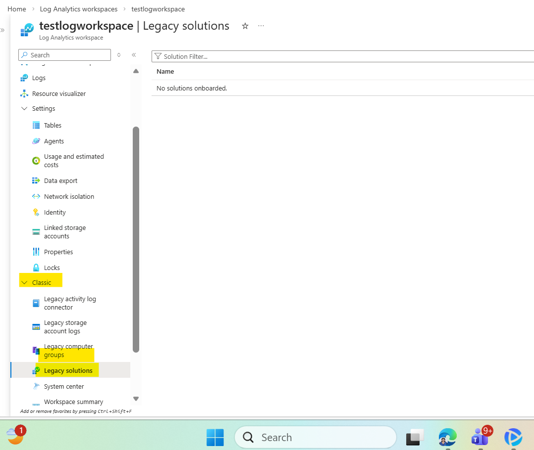

    Please have a look into below shared steps:
    Step 1: Identify legacy agents
    • Find machines with MMA/OMS installed
    • Check which Log Analytics workspaces they report to
    Microsoft provides:
    • AMA Migration Helper Workbook
    • DCR Config Generator to assist with discovery and mapping.
    Step 2: Create Data Collection Rules (DCRs):
    • Recreate existing data collection (events, counters, logs)
    • Point DCRs to the same Log Analytics workspace(s)
    • Validate that AMA supports each data source you collect.
    Step 3: Deploy AMA:
    • Install AMA on Azure VMs, VMSS, and Arc-enabled servers
    • Use Azure Policy for scale and auto‑deployment
    • Associate machines with the correct DCRs. [learn.microsoft.com]
