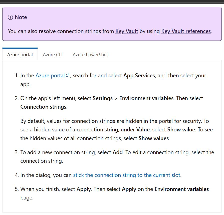

    Thanks for confirming during the offline discussion that the issue is resolved. The connectivity issue between the Azure Cloud App Service and the on‑premises MS SQL Server was addressed by creating and configuring a Hybrid Connection. The required SQL connection string was then added to the App Service configuration. Connectivity was validated from the App Service runtime using a PowerShell command executed from the Kudu (Debug Console). The validation returned “Connection SUCCESSFUL! The Web App can reach the SQL database”, confirming that the Azure App Service can now successfully connect to the SQL Server.
    Reference :
    https://learn.microsoft.com/en-us/azure/app-service/app-service-hybrid-connections?tabs=windows
    https://learn.microsoft.com/en-us/azure/app-service/configure-common?tabs=cli#configure-connection-strings

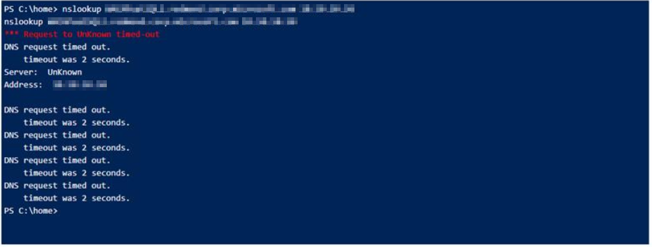

    1. DNS and name resolution
    • The nslookup timeout in the screenshot indicates the DNS server at 10.50.50.50 is not responding.
    • Either:
      • Fix connectivity to that DNS server (same VNet/peered VNet, NSG/UDR/firewall rules), or
      • Configure the web app’s VNet integration/subnet to use a DNS server that can resolve the SQL VM’s name, or
      • Connect by the SQL VM’s private IP address instead of FQDN.
