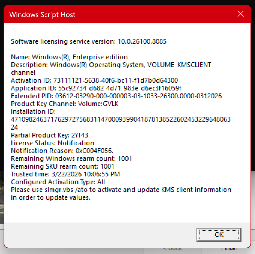

my last windows insider update caused an error and now windows is saying i need to activate this copy of windows and my troubleshooter for it is not responding either. the error code is:
0xC004F074
Windows Insider program | Windows Insider preview | Install, activate, and Windows update
  1. Pauli O 15,365 Reputation points Volunteer Moderator
    2026-03-23T08:24:02.8433333+00:00
    You have Windows Enterprise edition using generic volume license and those are for big organizations, not for consumers.
    To remain activated that device must be connected to organization KMS-server.
    Do you ever have been activated Pro edition on that device?
