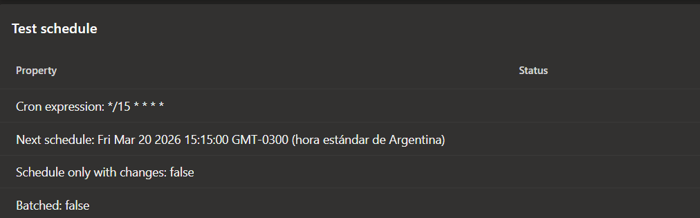

We have a pipeline connected to a Bitbucket repository. If we configure the continuous integration trigger, it runs successfully. However, the scheduled pipelines do not work.
I have done a lot of research and tried many solutions, but nothing has worked for me.
I set up a scheduled pipeline in the YAML file that should run every 15 minutes:
schedules:
 - cron: '*/15 * * * *'
   displayName: Test schedule

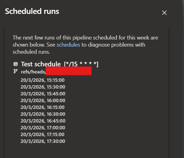

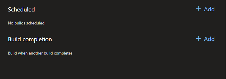

I have checked that there are no settings in the UI.
The pipelines are displayed correctly but never run

    4. Double-check your YAML schedule (just in case)
         schedules:
           branches:
             include:
             - main
           always: true
      You’ve got that right, and you already see the preview of upcoming runs, so Azure Pipelines definitely picked it up.

      • You already confirmed there are no UI schedules overriding YAML, which is another common cause.
