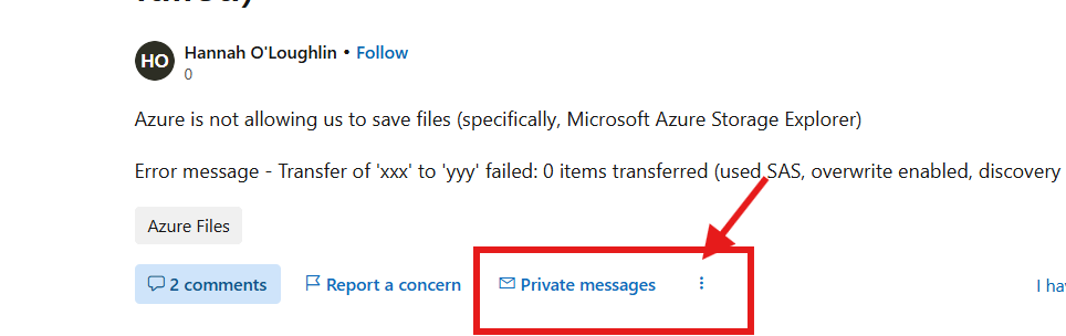

Hannah O'Loughlin 20 Reputation points
2026-03-20T20:48:59.6666667+00:00
Azure is not allowing us to save files (specifically, Microsoft Azure Storage Explorer)
Error message - Transfer of 'xxx' to 'yyy' failed: 0 items transferred (used SAS, overwrite enabled, discovery completed)
